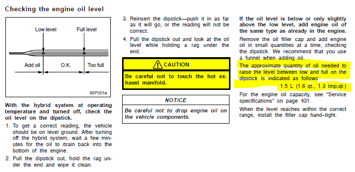

    Have you established the rate of consumption, for example how many miles to be a quart low?
    The difference between the two dipstick marks represents 1.6 US quarts:
