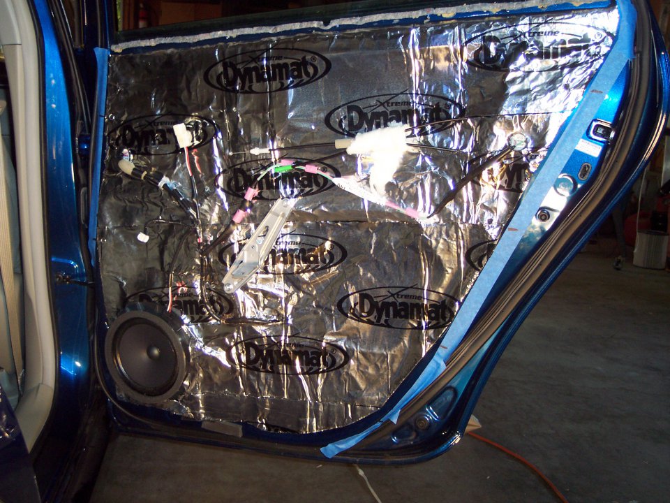

  10. phoenixgreg
    phoenixgreg Senior member
    Apr 7, 2010
    1,157
    291
    66
    Phoenix
    Felt tape or felt tape you make from 8 1/2 x 11 sheets of felt available at Michael's (black with sticky backing) could help where the plastic door panel meets the metal frame. I also discovered the fabric insert on my passenger door (above the armrest) had defective plastic welds only visible from the backside of that door panel. Some really good plastic glue to redo the welds worked wonders on mine. I also went for Dynamat:
    Skunkworks likes this.
  11. Skunkworks
    Skunkworks Member
    Jul 5, 2013
    101
    My 2011 does the exact same thing, I'm dynamating the doors and using foam tape as well
