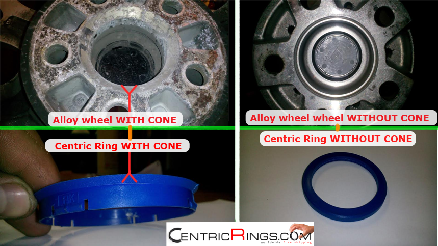

    Wheel Hub Centric Rings are designed to fill in the gap between the hub of the car and the center bore of the wheel. Most wheel manufacturers design their wheels with a centerbore large enough to fit on most cars. Therefore, since wheel manufactures make their center bore large enough to fit most cars, most wheel fitments have a gap between the hub and the centerbore. This gap usually doesn't allow for the wheel to fit hubcentric but rather lugcentric which causes vibration. Therefore, to fill the gap and ensure the fitment is hubcentric, hub rings are used.
    Centering hole disc must match exactly the size of the landing cylinder hub and no tolerance there can not be. If you want to install on the disk hub centering hole larger than the diameter of the cylinder Hubs, you must buy the wheel hub centering rings.

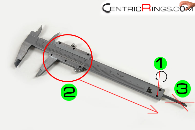

    To measure the diameter of the hub and diameter of the disk central bore you need Calipers
    To measure diameter of the disk hole You must have Calipers without depth probe or :
    1. unscrew the two bolts from the calipers
    2. remove the second part of the calipers
    3. remove the depth probe (DEPTH PROBE - makes difficult to measure accurately)
    Now you can precisely measure the diameter of disk center bore :)

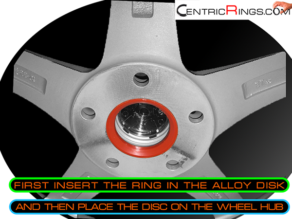

    HUB CENTRIC RINGS How to install:
    The HUB CENTRIC RING installation order:
    1. First insert the ring in the alloy disk (wheel).
    2. And then place the wheel(disk) on the wheel hub.

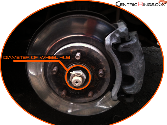

    What is HUB DIAMETER (IN DIAMETER)?

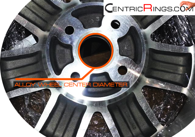

    What is wheel center bore (OUT DIAMETER)?
