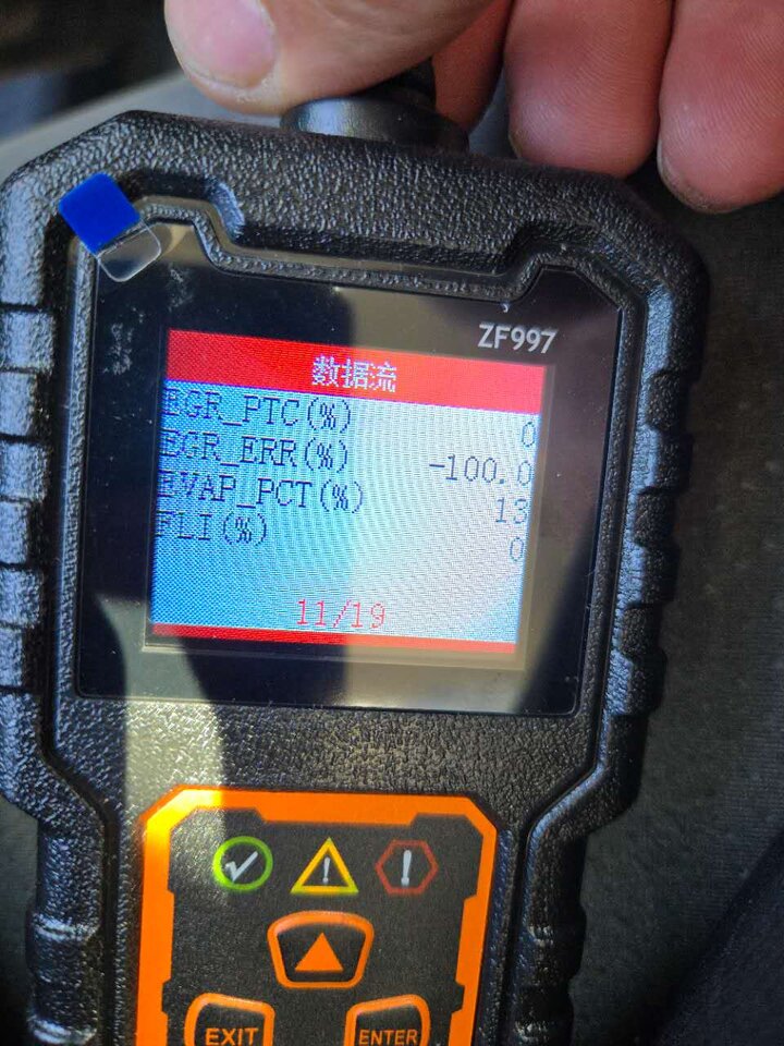

    OBD reads data

  17. wukong sun
    wukong sun Junior Member
    Apr 23, 2025
    66
    95050
    That's my opinion
    The data makes sense
    I also cleaned the EGR system
    Still has the vibration
    Are you not allowed to give my opinion?

    The EGR data your scanner is showing is not correct. This was noted by ChapmanF in the thread that you created for your car. https://priuschat.com/index.php?posts/3534666
    I do not understand why you are posting in this thread.
