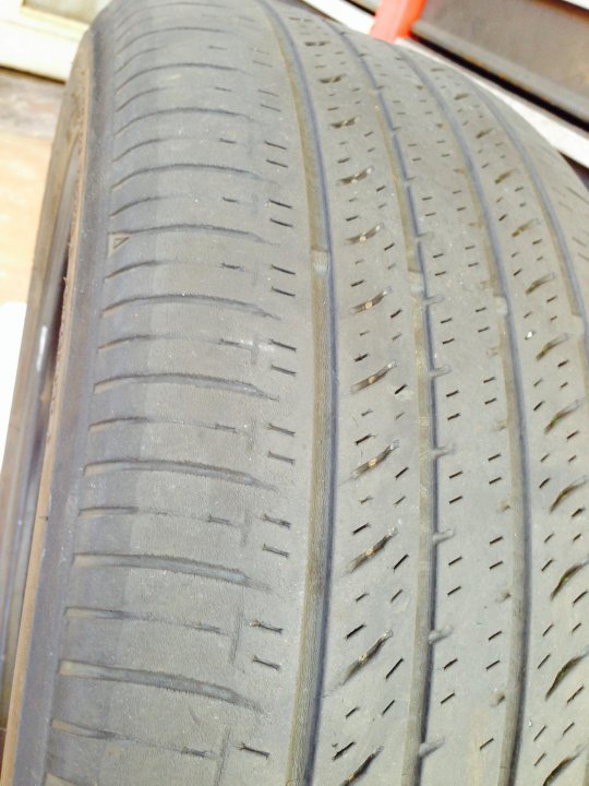

  14. bisco
    111,568
    50,804
    looks like some wear on the edge? might need alignment or balancing or something. all 4 the same?
  15. rdgrimes
    rdgrimes Senior Member
    Jun 7, 2013
    1,740
    448
    New Mexico, USA
    2018 Prius Prime
    Some under-inflation, but the wear bars are not exposed. Hardly "bald" by any definition.

  17. KennyGS
    KennyGS Senior Member
    Mar 28, 2014
    1,243
    1,044
    Keystone State
    There's still a fair bit of life on those tires @ttran76
    I agree with @rdgrimes. Make sure to keep a close eye on your pressure.

  19. nsfbr
    nsfbr Member
    Jan 6, 2014
    112
    30
    Northern Virginia
    2013 Prius v wagon
    So, first off, those aren't bald. And yes, you are underinflating them. Pump them up! 42/40 for me. You will get better gas mileage and the car isn't working so hard to remove the rubber from your tires then.
