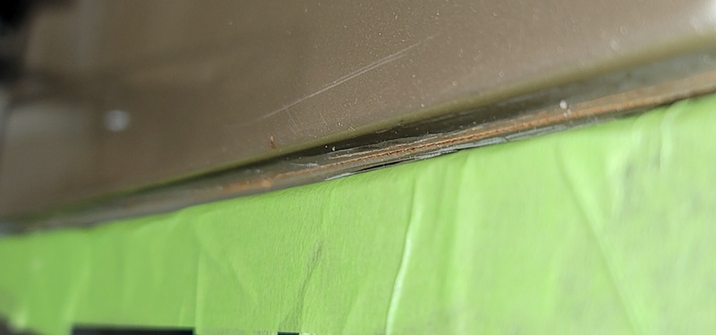

    • NOTE: I am concerned about the weld seam from roof to body in the gutter on the front of the roof. About six inches of the seam is rusting on driver side. Looks like inadequate paint covering. I'll take care of it while fixing the edge dings. See photo...
