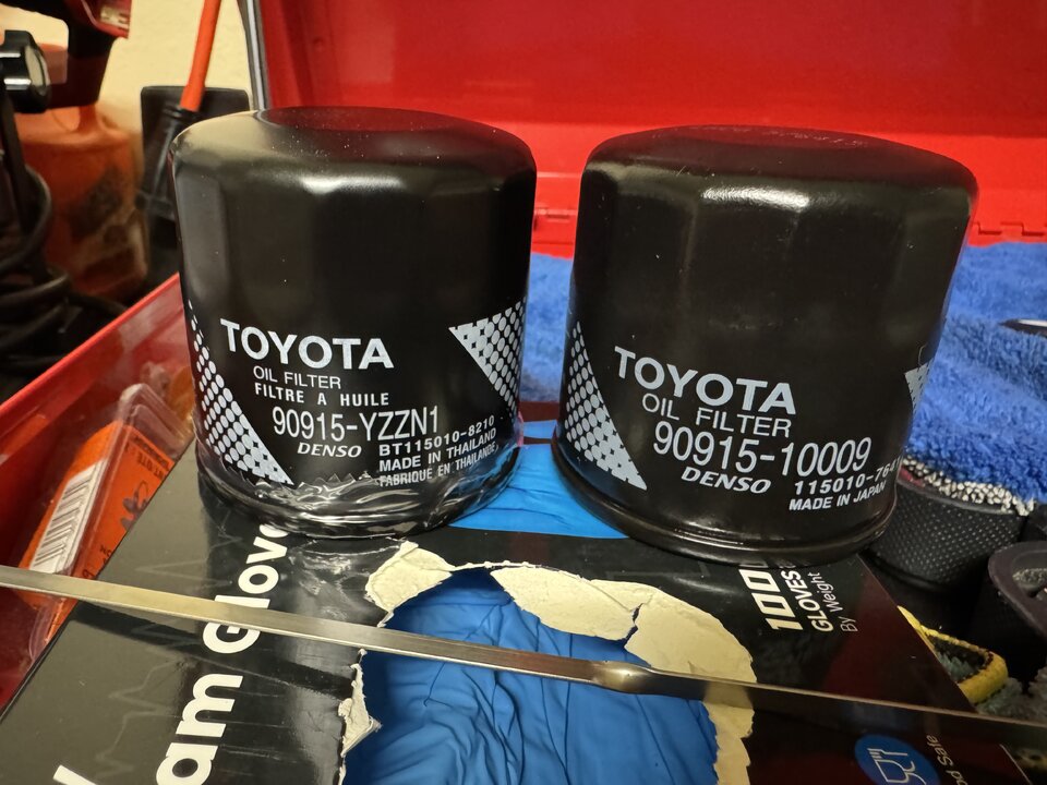

    Using called out: 0-W16 & 90915-YZZN1 -Toyota branded oil and filter.
    According to ALLdata and user manual specs. the oil capacity for drain w/ filter is 4.1 US QTs, which is less than my 4gen regular Prius and my 3gen, both being 1.8L motors.
    I’m happy to see that this time the replacement filter you can get at the dealership (N1) is the same size as the one that came installed from factory (Japan made) …on my 2022 gen4 the factory Japan one was a bit longer than the (again N1) made in Thailand that you can get at the dealership, so there is that.

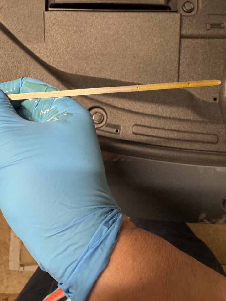

    I also noticed the oil level from factory was a little bit above the max mark/dot both cold and operating temperature, but not concerning, very clear seen on both side of the the dip stick, which I recorded for reference.

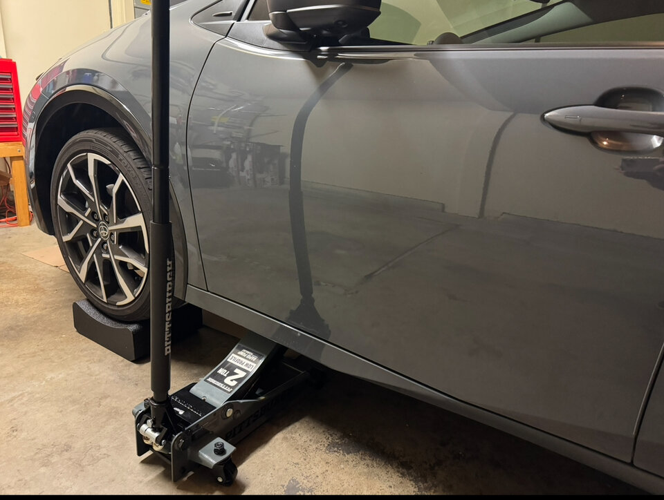

    Also, I noticed my Harbor Freight jack I needed to purchase to clear the suspension for the 19” wheels it’s almost a perfect color match???

    now… I realize the the 4.1qt is for reference only, dip stick should be used for measurement, therefore I filled with 4 + 0.20 QTs (so I added just a little bit from the fifth quarter bottle to prevent over fill) then I would top off later if needed with car leveled to the ground… Ran the engine in maintenance mode for 3 mins, checked for leaks, then put the cover back and lowered the front end.
    HERE is the thing & where I need your input…
    When checking the dipstick, between the min & max marks, level it’s a little over the middle so between the two dots (no top off oil was added after the mentioned 4.2qts)
    I left it alone overnight and rechecked this morning (cold) and level is about the same on one side of the dip stick, like: how much oil should I add to top off?
    I’m new to this 2.0L engine being a new design comparing to the old 1.8L, for those of you with the 5gen.
    -how much oil did you actually use? I don’t want to over fill it. And what makes it harder… on the other side of the dip stick it’s really inconclusive, really hard to read the level, it looks like (all wet passing the max dot, not distinctive level that I can read) so I’m not sure if I should add more oil using the side of the dip stick that shows level under the max dot.
    NOTE: uploaded photo of dip stick w/ oil level was factory fill before draining (I took for reference)

    You don’t need to worry about this. It is not a precise measurement. If it were, every car would be overfilled and suffer engine damage everyday.
    You get about one quart of leeway after the oil level reaches top mark on the dipstick before overfilling (oil making contact with the crankshaft, causing aeration and subsequent engine damage) occurs. So, even if you put half a quart more than the specced amount, it is perfectly fine.

    How so? I thought you said adding 4.2 (above the specced value 4.1) took you to just over the midway between min and max - just over where it should be. And then 4.5 took it to max.
    That sounds like the specs are right. The specced capacity would be how much they think you should need to fill it correctly, not the capacity to maximum.

    I'm just a little confused. Are you trying to get the oil to the max mark when the engine is cold or when it's at full operating temperature?
    When I change my own oil, I shoot for somewhere between the 1/3 and 1/2 area above min when the engine is cold. That leaves me plenty of room for the oil to expand as it warms and still keep it below the max mark. Now if my engine had 250k miles or more and burned some oil, then I might add another half qt to a full qt to give me some extra breathing room between top-ups. But for a new, clean engine, I'm going to keep the cold oil level a little below halfway between the dots.
    I also question if the specs are as far off as you claim. The spec is for draining the oil in a standard fashion(level car) and then refilling it to about halfway between the marks. What you did was to tilt your car to get extra oil out, then you filled it up to the max line. Why is it surprising that removing more oil than normal and then filling it up further than normal ends up with requiring more oil than the specs say?
