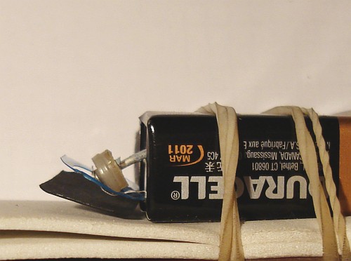

  7. bwilson4web
    28,153
    15,933
    What about using the vehicle jumper plug in the front. Of course there is the potential for a little fight:
    12 VDC, 600 A. auxillary battery vs. 9 VDC 450 mAH
    I'd probably want to use a pair of 6 V lantern batteries and possibly a diode to prevent reverse current flow.

    If you used the 9V battery, I think you definitely want to use the diode when you first plug it in with the 12V battery still in service to block the higher voltage. Once the battery is removed then the 9V current could flow to the ECU to keep the presets. Connecting it to the front jumper bar seems like the best idea since the 12V outlets are not connected when off.
    My co-worker was going to go by AutoZone and get some info on this 9V module that they used. Evidently this module must contain the blocking diode if he plugged it in to the 12V outlet prior to removing the battery. Of course you could easily make your own like the one you show in your picture. I need to look in to this.
