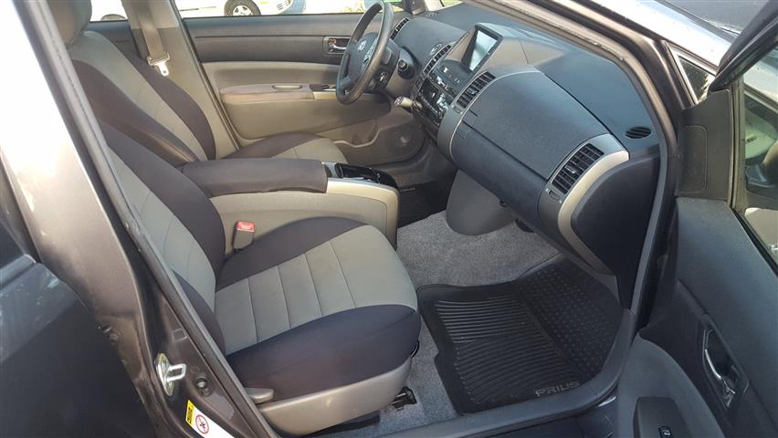

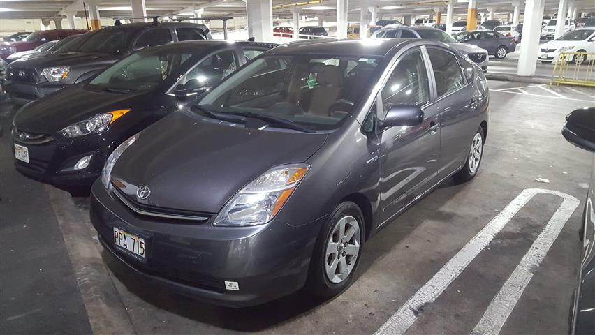

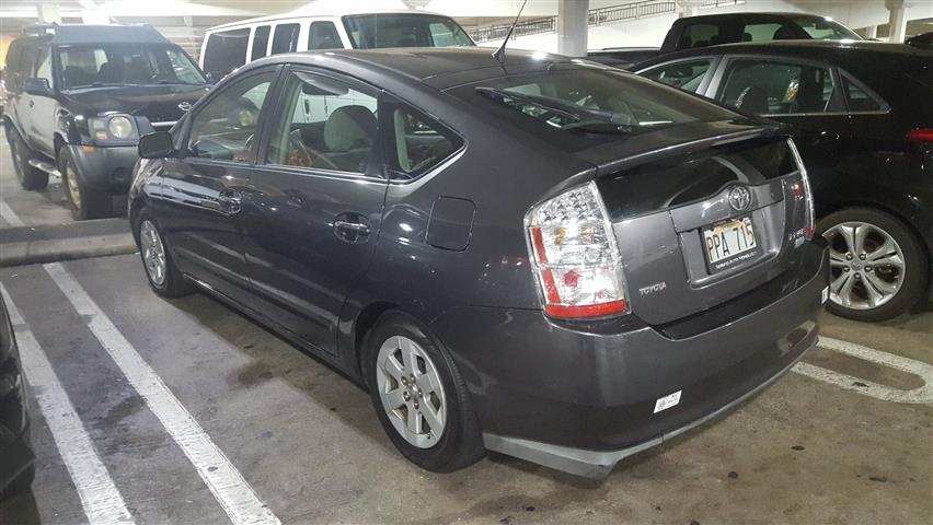

    Update w some pics. Not bad for 10 years and 90,000 miles

    clean!(y)

  16. Bunce
    Bunce Active Member
    Jan 5, 2018
    321
    185
    Oregon
    Nice seats. Are they covers? If so, where are they from?
    AlohaSpirit likes this.
  17. AlohaSpirit
    AlohaSpirit Junior Member
    Dec 18, 2017
    75
    23
    Hawaii
    Thanks
    Yeah, they are "wet okole" type seat covers

    Nice car, good luck with your Prius.

  19. Patrick Wong
    Patrick Wong DIY Enthusiast
    Mar 8, 2008
    18,200
    6,490
    Green Valley, AZ
    Or you could resell it.
    Parked at Ala Moana Center? I agree, the seat covers are quite nice. Not easy to log 90K miles in Honolulu.
