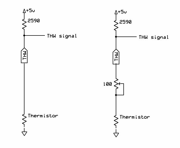

    However, there is one way not to have the idling. Just cheat the coolant temp is always below 70 C. :)

    Please refer to following schematics.
    The left one is normal and the right one is modified for the coolant temp (THW) thermistor.
    You can tell the normal temp to the engine ECU setting 0 ohm value of the variable resistance
    When the coolant temp is going to exceed 70C, set the ohm value to 50-100 ohm.
    You'll be staying in the S2 and the idling will never been occurred.
    Ken@Japan

    Hi Ken. Thanks for the reply. Frank mention above that this mod might set CEL, so I don't know if it will hurt anything by spoofing the coolant temp. I don't want to risk hurting anything on the car. I guess I'll be stuck with idling for now.

    I've been using it for about a month, and no error has been reported.
    It's neat I can let the ICE idle-checking anytime I want. :)

    Ken, nice to know that you are not getting errors with this mod. You said this "feature" is required by the system. Do you know why? By spoofing the coolant temperature, aren't you removing this "feature" from the system?

    I was the one originally spoofing the coolant temperature sensor; my original circuit was a bit different than ken's because I'm on a Classic and it doesn't have the same set of stages as the G2 Prius (specifically, there's no auto-stop at all below 70C). Whereas ken is adding subtle tweaks to the existing voltage, my circuit was basically completely overriding the actual temperature reading because in my case, I wanted the ECUs to think that the engine had reached 70C so that the Classic engine management algorithm would auto-stop.
    In my case, the first time I tried, it, I figured out what voltage was required for a reading of 70C and basically chose a resistor set to that value, and then started the car.. The engine ran for 10 seconds then promptly shut off and displayed the MIL and codes for P3101 and P3191 if i recall.. Once the cat has warmed up normally (ie, if you drive the car for 10 minutes first and then turn it off), you can spoof any value you want and the engine really doesn't care, but when it's cold, it's not happy if you lie to it... Alternately, if you can get on the road and drive for about a kilometer without stopping, as soon as you're moving, you can crank up the temperature reading and when you come to a stop, the engine will also stop, even though the actual coolant temp may still be well below 50C..
    What I'm doing now, is starting at no spoofing, allowing the engine to warm up slightly and establish idle, then I rapidly ramp up to 50C, which turns off the "cold temp" light and switches the VVT-i out of the low-power "warm-up mode", and then I ramp up to 70C based on vehicle movement and hold there until the actual temperature exceeds 70C at which time the circuit is switched out.. I've got a little microprocessor to monitor and control everything, but I'm still tweaking and and tuning the algorithm... Before ECT spoofing, my usual 1st 5 minute consumption bar was always between 7.5 L/100km to 10 (infinite) L/100km; with the spoofing, 7.5L/100km is the maximum consumption; depending on whether I have to wait at an intersection or whether I can just get going, I can get as low as my regular consumption of 4.8 L/100km on the first 5 minutes.. This applies even in the winter and was the difference between a usual winter consumption of 5.6L/100k or worse and the 5.2L/100km I achieved this past winter..
    Again, this is on a Classic, which doesn't have the same operational modes as the G2, so what I'm doing is probably not ideal for the G2, and ken's solution may actually be a better choice (and should never trigger a MIL either)

    I see. I am still not quite sure what "idling rpm to meet the current contamination of the throttle body" means. Can you provide the location of the THW signal in your schematic? As I gain more confidence and understanding on this issue, I might probably do this mod some day. TIA!

    Me neither. :blink:
    You have to join the http://techinfo.toyota.com/ site. :)
    Anyway, The THW signal is located at E4-19.
    Ken@Japan

    And not carefully the weird ordering of the connectors down the
    ECM -- 4,5,7,6 ... that's NOT a typo.
