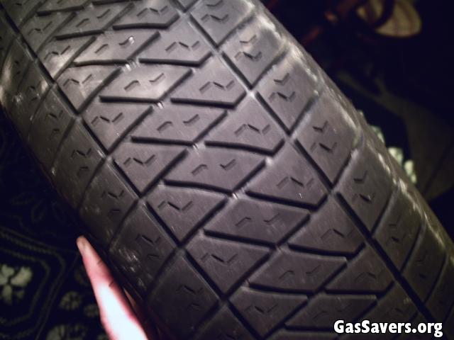

    Seriously people, if a tyre has cracks or is distorting or delaminating change the bloody thing before it kills someone but the age of the tyre shouldn't be an issue if tyres are inspected and maintained properly. Cracks in sidewalls occur due to exposure to sun wind and rain, none of these are issues in a resellers store room normally. De-lamination is a manufacturer defect or caused by bad road surfaces or air finding its way between the layers, this only happens when the tyre is in use.
    In this image you can see the tread is bulging near the guy's thumb,
    [​IMG] replace a tyre like this now, it will often make a noise.
