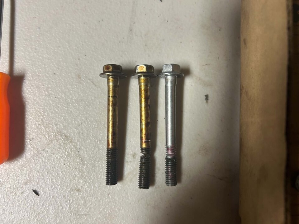

    Well, my new cam assembly bolts came in. I'm pretty sure every single one but maybe 3 stretched.
    I made sure I was reading my torque wrench right this time and didn't have any problems with the timing cover bolts.
    It's the 17 "gold bolts" for the cam assembly. 90105-08455 is what I bought as a replacement. Turns out it's 16 of those and 1 is a short bolt. It's 20ft lbs, right? I don't understand what I'm doing wrong.
    I worked them snug, because there is the valve springs pushing the assembly up. Then I did the bolt pattern to 10#, I noticed it was a bit off. I assumed it was the RTV squshing. Then I worked in 20#, same thing. It would click and I'd go to click it again and it would turn 1/8-1/4 turn more before clicking. I couldn't get a solid stiff click from the majority of the bolts. One started to keep going without clicking, so I took it out.
    Picture, left to right. Old good bolt, old stretched bolt, new stretched bolt. The other picture shows the stretched to the brand new. From under the bolt head, they measured, 2.750", 2.853", 2.806".

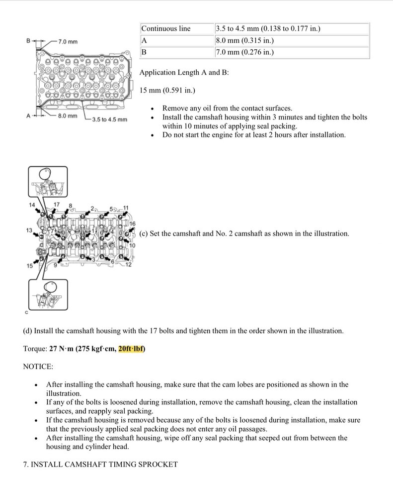

    The spec is Torque: 27 N·m (275 kgf·cm, 20ft·lbf)
    1 NM is 0.7376 ftlbs
    20 NM IS 14.75 ftlbs which is reduced torque.
    Use of oil on the threads can cause stretching even though the torque wrench indicates 20 ftlbs. Most Toyota torque specs are for clean and dry threads except for the head bolts where a specific lubricant is recommended.

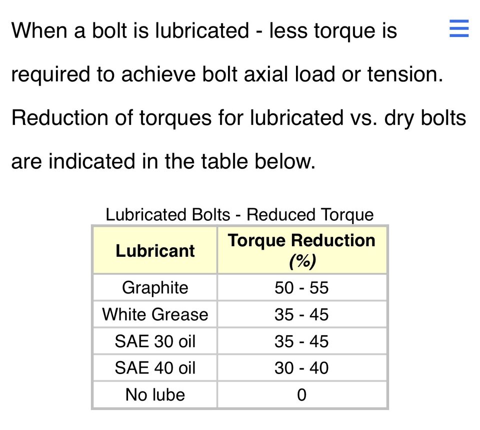

    RTV is not oil. Torque values are specified as dry or lubricated. When dry is specified, an oil like SAE 30 can make a bolt get tighter with less torque.
    If you lubricated with 30 weight oil you would have to reduce the torque by 35-45% to end up with proper tension or clamping force.

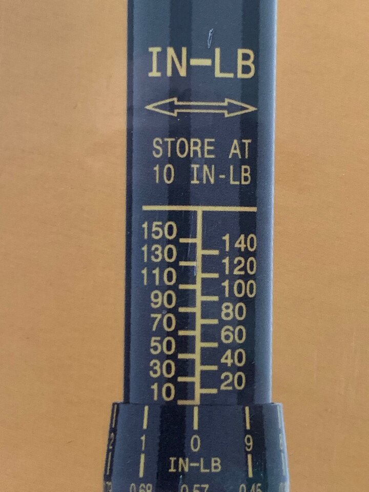

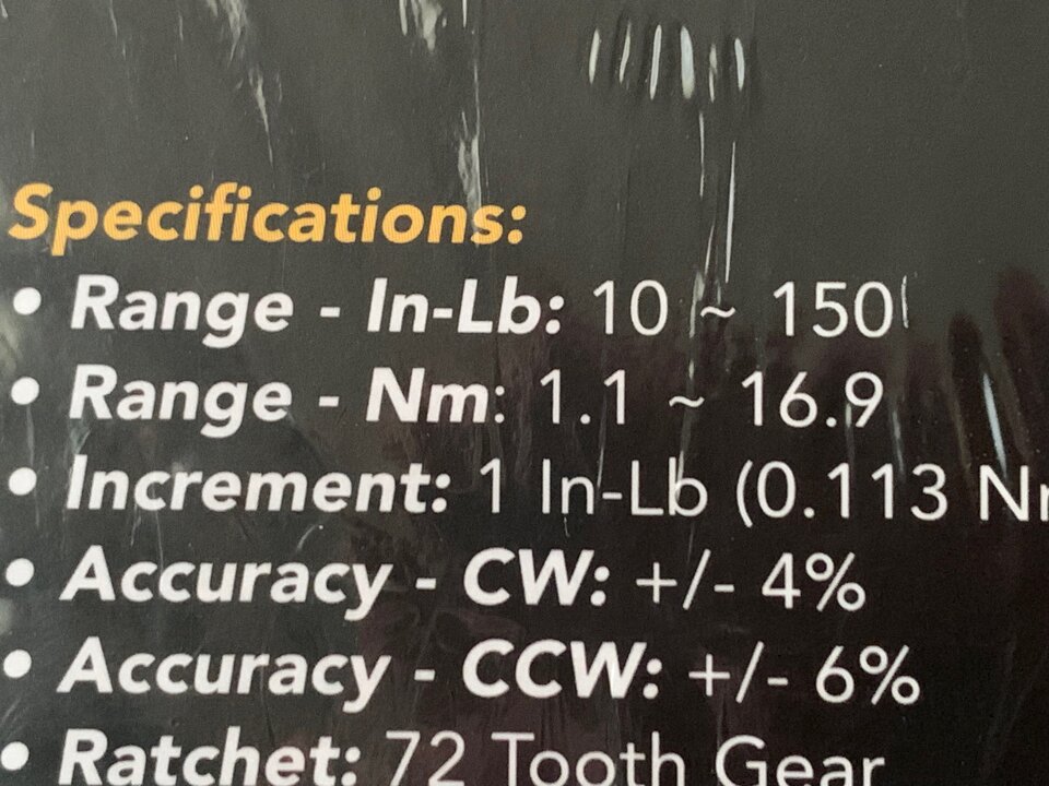

    Here is my torque wrench and what I set it to, when I torqued them. 20ft lbs. I bought another set of head bolts and put them in... I really don't want to take everything back apart, again.
    I don't understand how I got 30lbs out of the original set and can't even get 20lbs out of the new set. (Cam bolts) 10lbs wasn't even getting a repeatable click. (wasn't exactly trying)
    Maybe some motor oil got in the threads and I should try 10-15lbs on the next set?
    I was talking to my boss who has done some engine work before and he said the engine he was working on was 8ft lbs.
    I thought about getting one of those digital adapter torque wrenches. To see if my wrench is that off. But think it would be a waste of money. Cheap and cheap...

    No. Now you would be guessing. Clean and dry at 20 ft lbs. Clean like dogman suggests.
    The repair manual says 20 ft lbs as listed in the attachment in post 5.

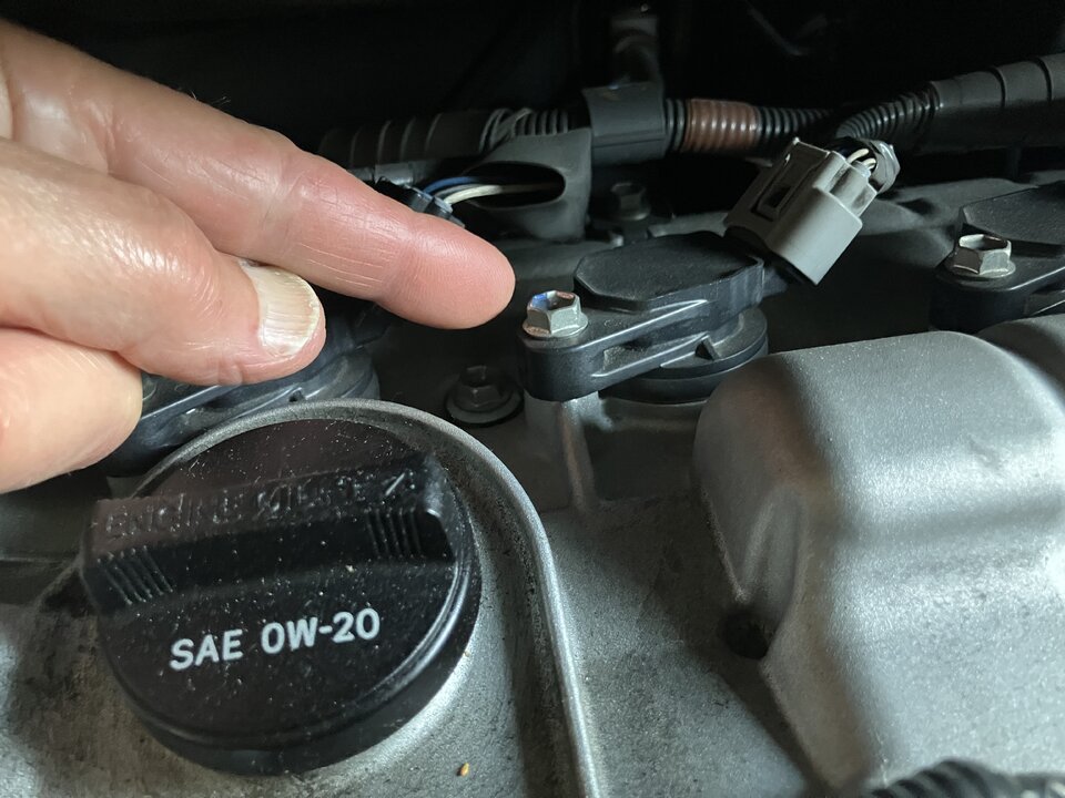

    That's happened more than once with these:
    They're trivial locator bolts, purely insurance against something rattling loose. Snugging them is all that's needed. Unfortunately Toyota spec'd the torque, which is something like 48 in/lbs, and few innocent souls dutifully got out their ft/lb torque wrench, took the heads right off.
