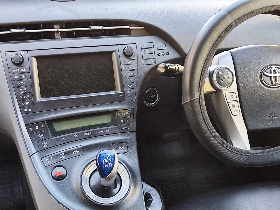

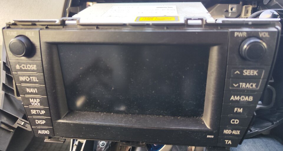

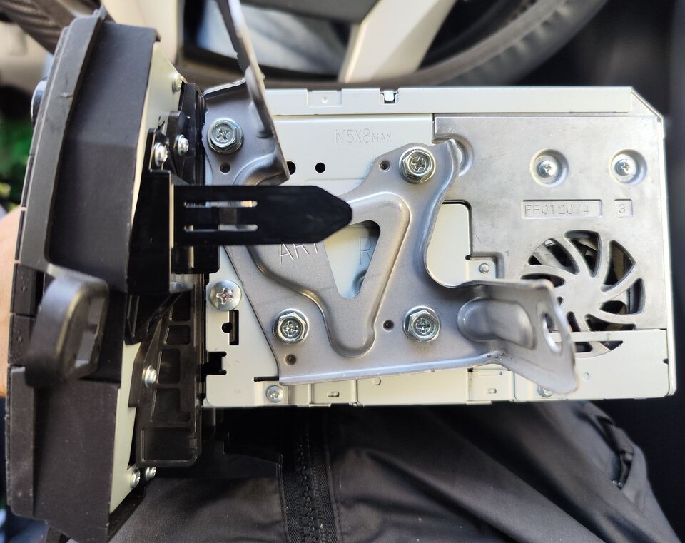

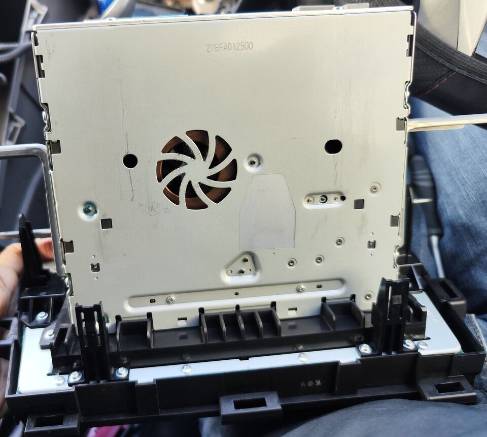

    Hi all, looking to upgrade my 2010 Prius (UK RHD, not Japan import). Pics of current unit attached.
    Current:
    • Toyota SAT Nav 86120‑47410
    • Factory reverse camera
    Looking for Head Units with:
    • Android OS
    • Bluetooth + Wi‑Fi
    • if possible 4G/5G SIM
    • GPS / offline maps
    • Retain reverse camera & steering wheel controls
    • Optional: Apple CarPlay / Android Auto
    Thanks in advance for advice, tips, links, or experiences!

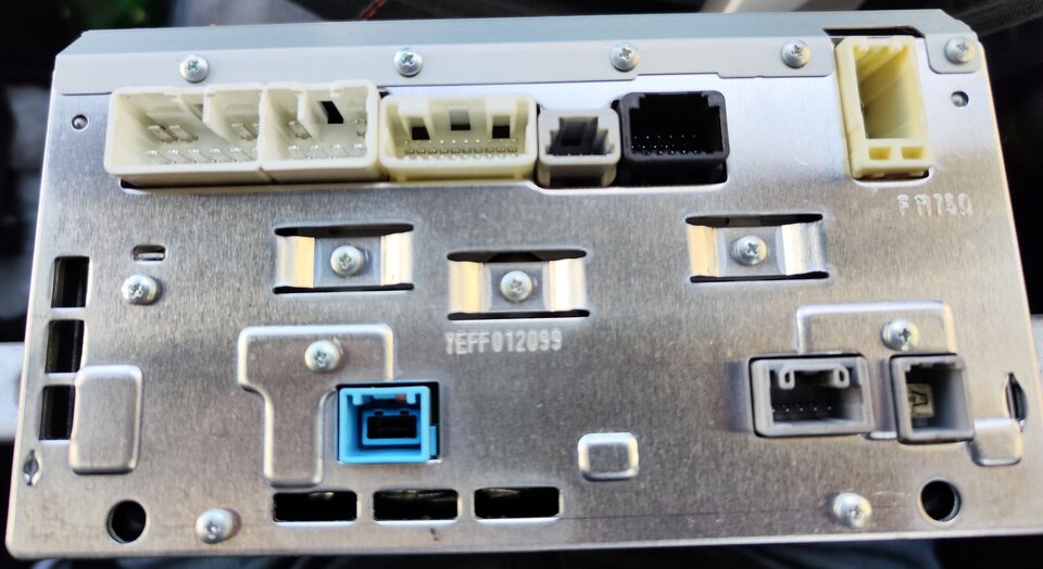

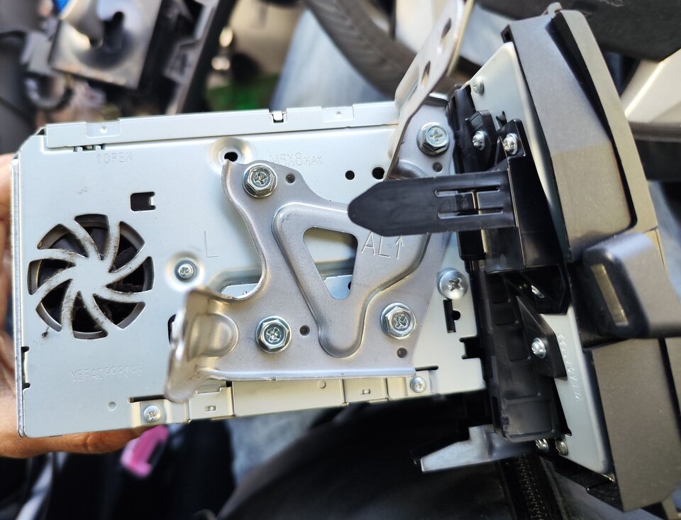

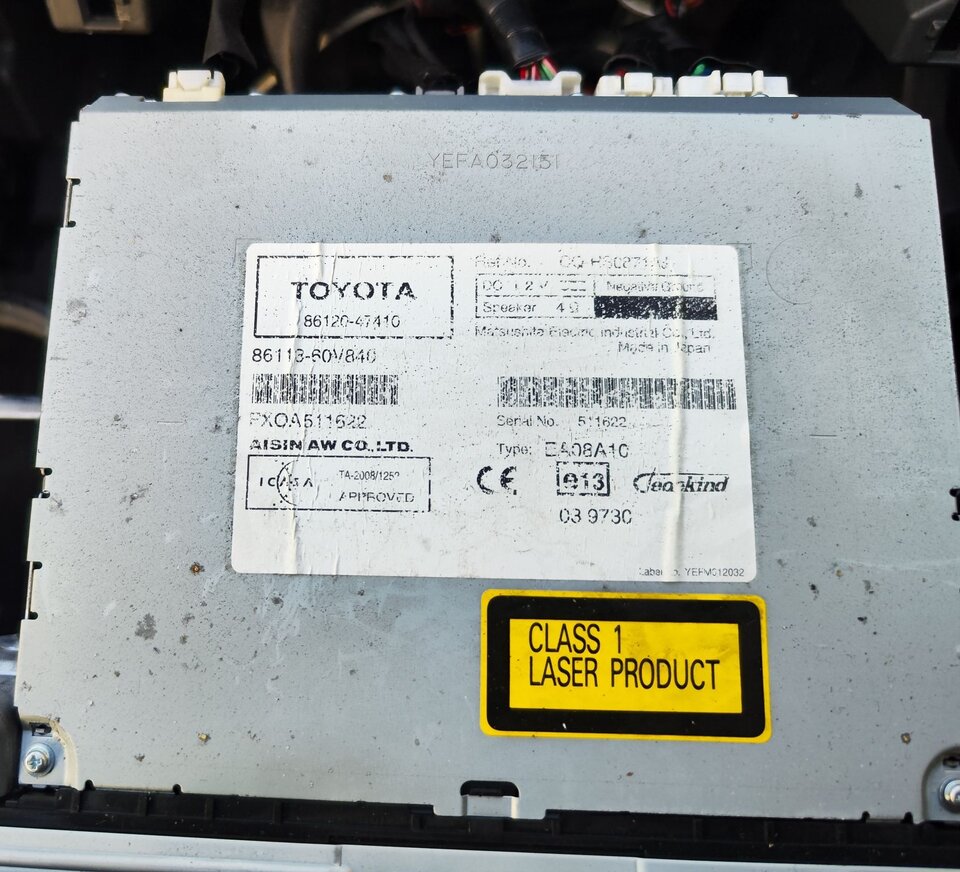

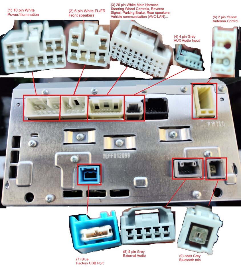

    Where can I get the wiring diagrams for my headunit? Attached picture of current headunit 86120-47410
