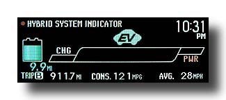

    Just turn the car on.
    You'll see this:
    And have access to this:

    In addition to what John posted: You can use a ScanGaugeII or other similar device (Torque App on Android with a bluetooth ODB-II reader/sender) to read SOC (state of charge), battery pack voltage, Amps in/out of the battery, and host of other charging/battery related values. However, you can only read this information while the car is on. Once the car is off, the ECU goes to sleep and whatever OBD-II tool you are using loses communication with the car.
