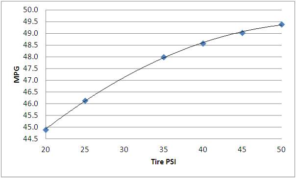

    Here is what I got using the equations in the article for one tire.
    I assumed MPG change is 20% of rolling resistance change (TireRack.com says its really 10-20%). This is for warmed up "equilibiurm" tire. Assuming 35 psi is base case, note that going below 35 psi is more rapid fall off.
    Going to check my pressure right now: 32,34,34,35 lets add some air!

    That doesn't seem like much of an increase to justify intentionally going to a higher psi. I would imagine the car would have a rougher ride, who knows on the wear of tires.

    I think the shape of the curve is correct, so falling below 35 psig (especially right now as temps plummet) could start to shave off MPG. So the main thing keep them a little over 35 psig so they don't fall below 35 psig. Perhaps the shape of the curve is correct but the effect is bigger for modern LRR tires? (that article was 1980-ish)

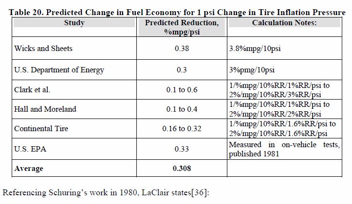

  9. hlunde
    hlunde Member
    Dec 22, 2009
    419
    75
    from epa.gov
  10. wjtracy
    wjtracy Senior Member
    Sep 19, 2006
    11,357
    3,604
    Northern VA (NoVA)
    ^^^...seems reasonable...the tire handbook that I referenced above was by "Clark" in hlunde's post.
    Clark and Dodge make the point that the pressure effect is 1/P (reciprocal pressure) so the effect should be bigger on the low side.
