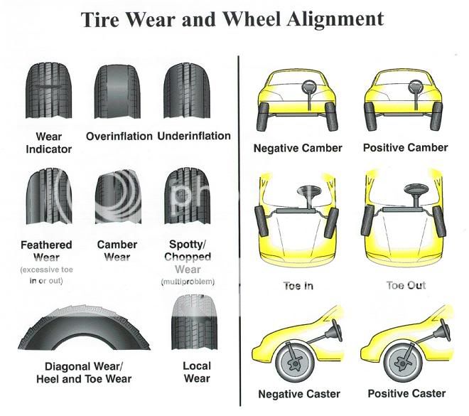

    Found a cool chart. I didn't realize excessive wear due to toe and camber looked almost similar.

    get it aligned and report back. I would bet it's toe!
