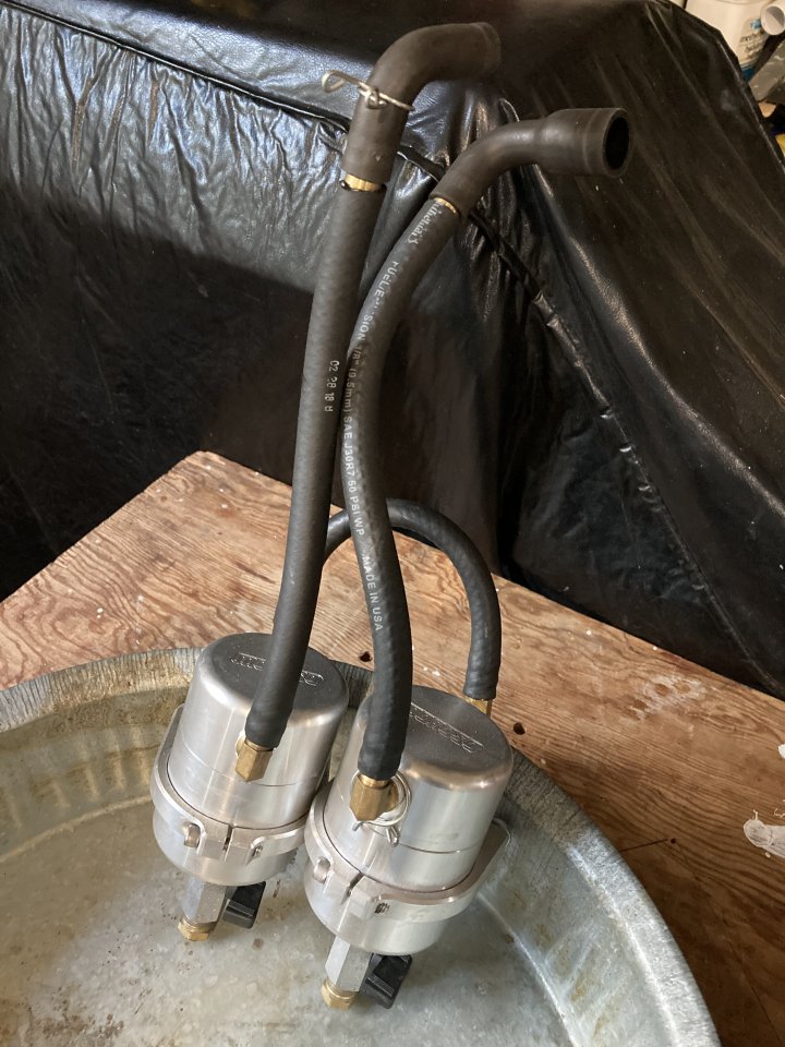

    I'm using Moroso 85474 can (two actually, long story) in series. It's good, very solid, but pricey. I've mounted them on a slotted angle bracket attached to the cross-beam below the intake manifold. Lot of people have mounted up higher, in the corner just behind driver's side headlight.
    My setup, off the car:
