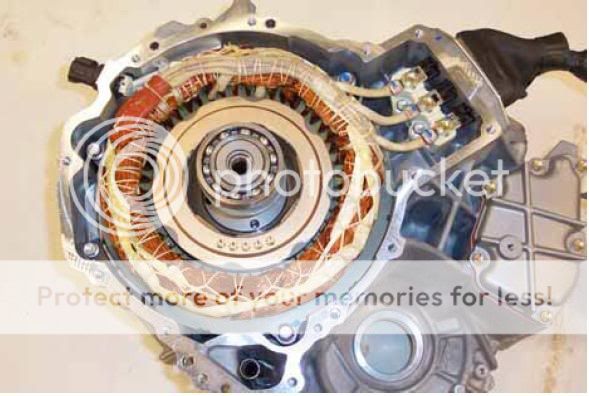

    Elsewhere it is written that the MG windings are directly exposed to the ATF. If that is true there's no way to be certain how their insulation will react given long-term exposure to other fluids, so I wouldn't risk anything other than the recommended Toyota fluid. ORNL certainly won't pay up if the Toyota warranty is voided :_>

    A picture is worth a thousand words...stator windings definitely exposed to transaxle ATF.

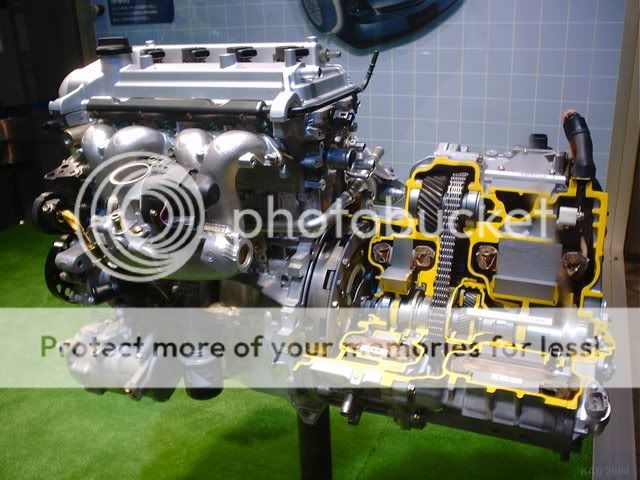

    I've thought about this for a few years. Originally I accepted that the windings were immersed in the fluid, or at least exposed to it. I changed my mind when I realized that the large oil cooled transformers require a special non-conductive oil, even a trace of metal additive would cause an internal short and explosion
    If the WS fluid was unique just to the Prius, I would accept the idea of electrical use. However, the same WS fluid is used in many Toyota automatic transmissions, such as the 5 speed auto in my FJ. A modern ATF has many additives, such as friction modifiers, to allow the clutches/bands to properly apply without slip or shudder
    I have yet to uncover any convincing arguement that WS fluid has any special electrical properties, at least compared to conventional ATF's.
    I looked around and came across these cutaway photos of the CVT case. It appears that MG 1 and 2 are sealed, but correct me if I'm wrong

    At least with this model, the stator windings are exposed to the transaxle fluid. Bits and pieces of plastic insulation (presumably from the windings) were found in the drain pan.
    You'll recall that a PC member recently posted about his experiences replacing a 2G transaxle. Unfortunately he never got around to disassembling the failed component to see what it looked like inside.
