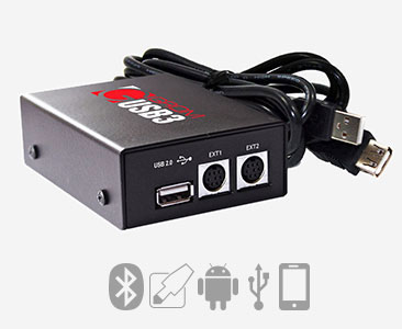

    Hi Sandy, I don't know whether you've done anything with this yet, but I put a GROM in my '03 months ago. It was well worth it and the install was a breeze. I've only just registered at the site recently and apparently haven't posted enough to provide links! But just look up GROM's website, plug in the car info and you'll get a page of options. I went for the TOYOU3 - little black box with USB port plus 2 DIN connectors of some kind. Hopefully the pic below will show up. It goes Bluetooth if you buy the adapter (which does into one of those DINs).
    I ended up ordering from GROM's store on eBay because at the time they actually listed it there about $10 cheaper than their web page.
