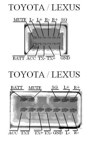

    Here's the pinout information that I found online (the only one I could find) that shows the pins matching 1:1 on the 2003 an 3004 connector (with the exception of the 'TXT' pin, which seems to be an eject pin) - see attached image.
    On this paper, that 'TXT' pin is actually labelled as Eject on the connector (pin 11): perens d0t c0m/works/hobbies/ham/prius/avc-lan/avc-lan.pdf

    1) I need to properly terminate the new device, with a 120 Ohm resistor across the TX+ and TX- pins?
    2) I need to flip/switch the TX+ and TX- pins, as perhaps the labelling is relative to the direction (similar to RS-232 DTE/DTS).

    My trouble had to do with the G1's apparently unusual use of pin 11 for an eject button. Does the harness you've built in any way tie the eject pin to your new Bluetooth device? You can confirm that if the car simply won't play tapes when your harness is in place. :) If so, make sure your Y harness does carry eject through from the cluster/switches board (so you can eject tapes) but does not connect it in any way to your Bluetooth thingy or to any other pin. Also note that the harness also supplies power to the cluster/switches and clock, so those circuits have to be intact.

    So you had to cut pin 11, which the perens PDF above says is Eject.. But I don't quite understand how that was crosstalking with TX-? If pin 11 was tied to TX- and Eject, and you snipped it, how is TX- getting back to the bus?

    Hmm, doesn't look like it. As you can hopefully see in the attached pic, pin 11 (the prominent grey wire) passes through the 'top' of the Y-adapter, but does not pass through to the bluetooth device..
    It looks like, on my harness, all of the wires going from the two arms of the 'Y' are connected, bar the eject and signal ground (I wonder if that's signal ground as in AVC-LAN signal..) - perhaps I should identify the 6 wires you defined as necessary and snip the rest. That should bring my harness up to date with yours, with the exception of the bluetooth end.
