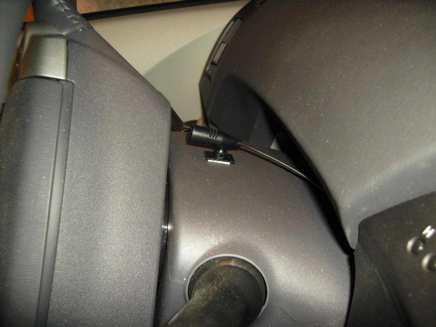

    Also...I found a really great place for the microphone. I'll post a picture tommorow but I basically pushed it between the steering wheel column, and the center console. It is out of site, everyone can hear me fine, and it sits there using just pressure, no tape or anything.

    Very clean. Here is mine, mostly out of sight between the steering wheel and console.
