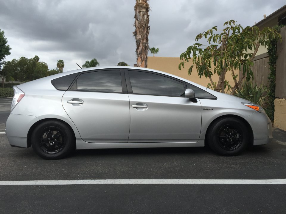

My car is lowered on Tein H-tech springs and I am running 18x7.5 +38 with a 225/45/18. I have very slight rubbing up front with the fender liners over bigger bumps because the tires are a bit oversized but I would think with a 215/40/18 you shouldn't have any problems at all!
thnxs for the reply jesse, i jus saw ur car w xxr im buying the same wheels but in matte black finish....
