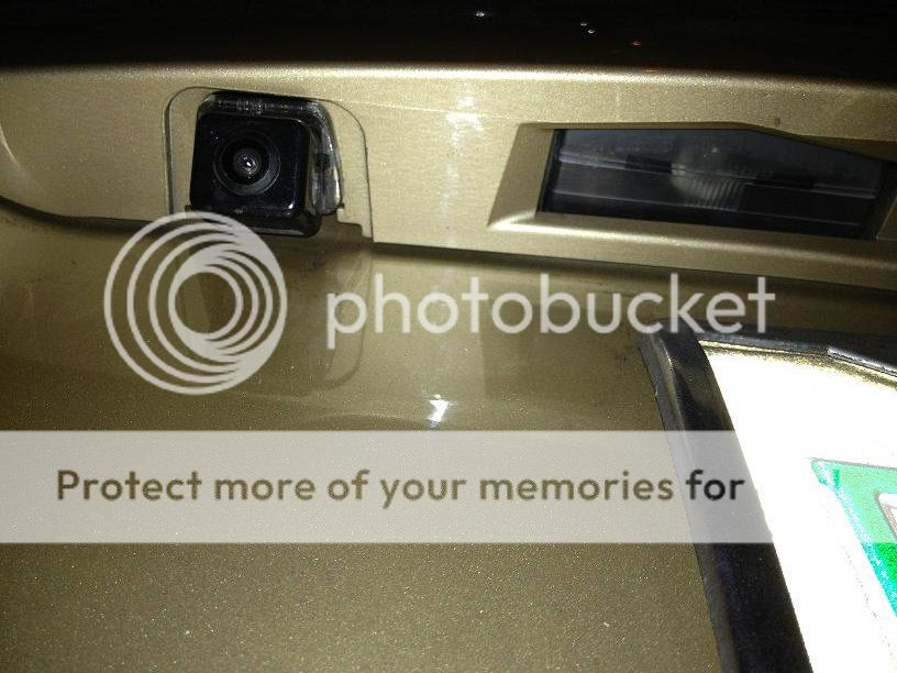

    Here is the OttoNavi backup camera on my 2010.

    Actually, that's where the OEM camera is installed on my Prius"v."
    It could be that's where the back-up camera option is installed on all Prii.

    This is what the OEM camera looks like on mine

    I like the cut on the plastic to install the cam, that one is with drilling thru or how?
    Which camera do you use?

    OEM, came with the car
