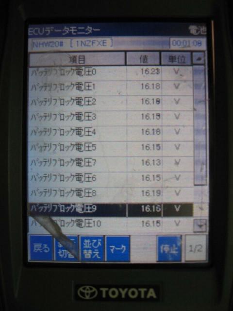

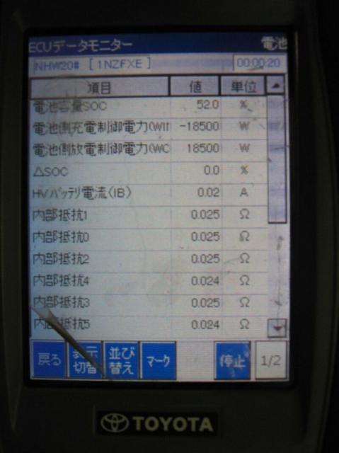

  7. ken1784
    ken1784 SuperMID designer
    Dec 18, 2003
    2,943
    1,380
    67
    Yokohama, JAPAN
    Hi Patrick,
    Sorry, but the dealer's OBD-II scanner has following capabilities to check the HV battery.
    • delta-SOC, variations among 14 pair of modules. should be less than 20%
    • voltages of each pair modules
    • internal resistance of each pair modules
    I would like to suggest ozymandias to visit a dealer to get the HV battery checked.
    Ken@Japan
