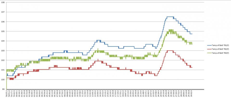

    I was monitoring 3 of the battery temps. They were all relatively close in temp, IIRC
    I havent "Torque'd" in a while.. but here's a graph I made for my 9/25/2012 drive:
    I dont remember, and didnt log, what the external temp was.. but being late Sept, it was probably on the warmer side.. maybe mid-70s to low 80s?
    I found the historical temp for that day and it was a high of 78F
    My battery temps rise at the end because thats where speeds pick up (55MPH) and I start going up hill.

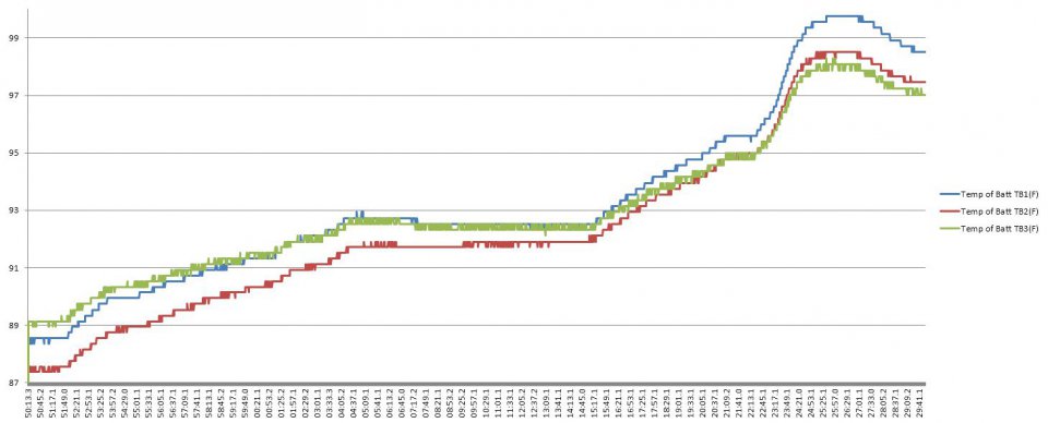

    Here's another from 11/13/2012. The historical temperature for that day shows a high of 83F. It doesnt seem right though since my battery temps started at about 87-88F. Back then, I was kind of parking in the sun.. very little shade until late in the afternoon.

    I dont think your numbers are bad.. probably as you pointed out, your driving style.
    Looking at my November 2012 graph, see where it plateaus? On that portion of my commute, speeds generally pick up (50MPH posted). But that section gets congested from time to time. It appears that day is was congested since the temps didnt spike like they did my my previous example.
    I think with somewhat conservative driving,t he temps wouldnt go up as much or as quickly. Also seeing as how my battery temps dropped a bit in between the two spikes (in the Sept 2012 example), I bet my AC was on.. or at least I turned it on around that time.
