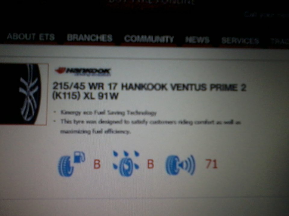

    2014-12-04 14.14.18.jpg 2014-12-04 14.13.10.jpg 2014-12-04 14.13.10.jpg 2014-12-04 14.13.10.jpg 2014-12-04 14.13.10.jpg these are the best fuel save tyres I have found b rating for fuel and b rating for wet and there are around £80 uk pounds each

    make sure you get xl 91w as there are 2 types and the others are not as good.

    not sure im on the 17 " wheels and the right tyre is a 215 45 17. and these are the best I have found even better then the standard Michelin's . they just roll better sound better make the car easy to drive less hard acceleration needed hence better fuel economy
