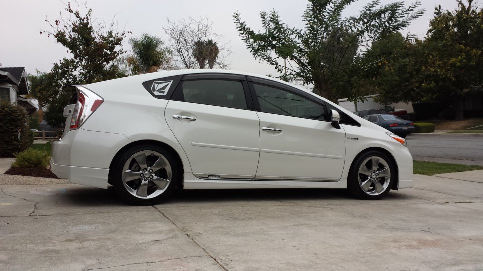

    I like my TRD Springs. Lessens the gap but mild enough it does not scrape. 20141010_074244.jpg

    Looks about perfect! I like it a lot.
    Did you do install yourself? If so how hard was it to do? Dealership quoted me $600 to install!!!! And no they weren't kidding...

    I did not install myself. A reliable shop should be able to install for half the price the dealer is quoting you.
