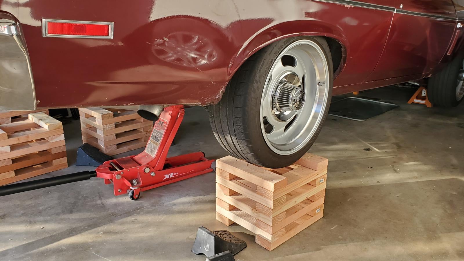

    Since the Prius is so low to the ground you really need to raise it up to work under it. When I engineered a temporary bypass of the heat exchanger I just jacked up one side of the car and used jack stands to secure it at a tilt to work under. But that makes me a little bit nervous and I'm looking for a better and more secure solution. I was thinking about buying a bunch of cheap 2x4s and making cribs like these. Anyone have any better ideas?

    It's hard to use cribbing as shown in that picture because the Prius has independent suspension. That picture has a car with a solid rear axle with the jack under the rear differential, if I'm not mistaken.
    When you jack up the Prius, the wheels hang down, unsupported. If you crib the wheels, when you lower the car, it will settle down on the struts/springs, and you'll lose much of the height you had the body jacked up to.
    That's why you can't jack the front of the car up and slide ramps under the front wheels, because the wheels are hanging down low.
