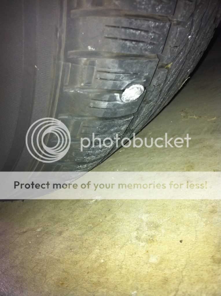

    here's a picture of the beast in my tire....lol. may not be a bolt but it's hard to tell.

    Looks like a roofing nail to me--should be repairable.

    tire is fixed! it was a screw, about a half inch or so. it looked like the kind of screw that comes with the build-it-yourself furniture. easy patch job, should be good now.
