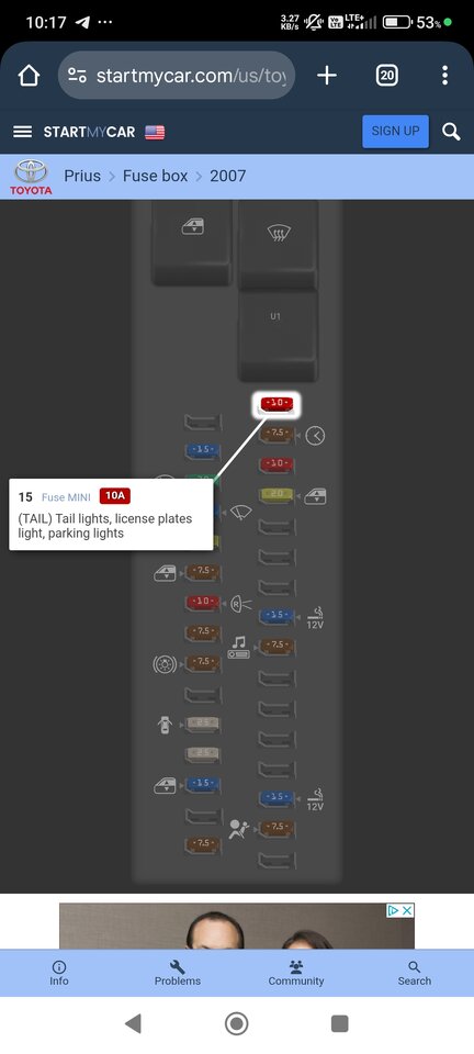

    1. I immediately thought that perhaps I had touched the wrong wires for too long and had broken a fuse. But the fuse is perfectly fine. I replaced it anyway but it didn't change anything.

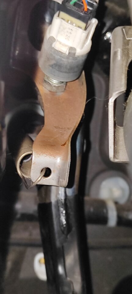

    2. That's when I noticed the brake not being able to put my car into drive. Then I thought maybe my car didn't see me pressing the brake pad at all and perhaps I had shorted the brake switch somehow. I got a brake switch from a junked Prius and installing it has made no difference at all.

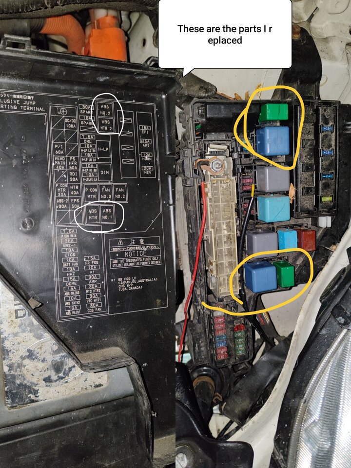

    3. I replaced any relays having to do with the ABS system and nothing has changed.

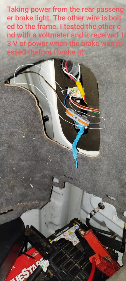

    So I found the connector that powered the passenger side rear brake light (and all other passenger rear lights). I found out that a blue wire on the corner was the only one that had power when my car was off and I was pressing the brakes. I cut the wire and spliced it using a "wire splicing connector" so I needed to do no soldering.

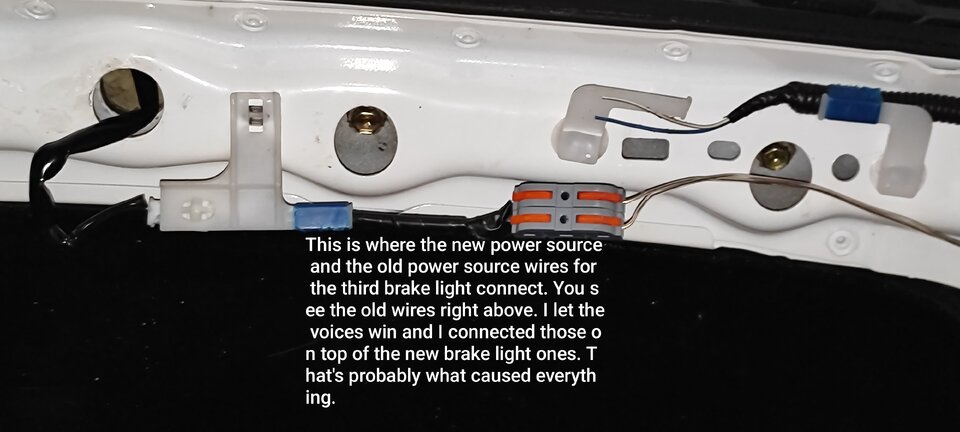

    I ran a set of wires from there up to the hatch and right where it needed to be to connect to the third brake light. I connected the wires with two "wire splicing connectors" ajd got the hot and neutral wrong but when I switched them it was okay and all three brake lights lit up when hitting the brakes...but the wires were too long so I had to cut them shorter.
    That's where I made a stupid mistake for no reason at all. I decided to use those connectors to connect the original power source wires as well as the new wires. I don't know what came over me. To make matters worse, I didn't remember which of either pairs of wires was positive or negative.
    I had forgotten which one was positive or negative many times ... putting them in the wrong order simply did nothing and I would switch them and it would be fine. Not this time.
    I was nearly done. I connected them one way and I connected them the other and this time none of the three brake lights would turn on.
