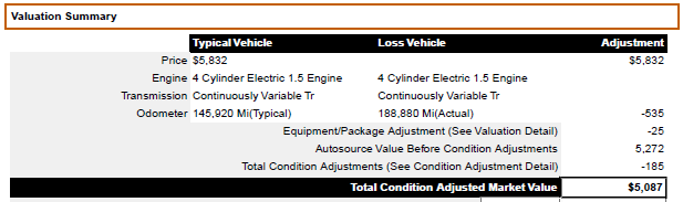

    Unfortunately my daughter recently hit a power pole on the left headlight and totaled the car (no injury, lo-speed crash - yeah, I know how in the...) - on the bright side, her catalyst recently failed and the car was due for DEQ inspection and new registration so we dodged that bullet. Insurance valued car today at $5,832 minus $745 for hi-miles, lack of cruise control and existing minor body damage leaving me $5,087 before deductible as shown below.
    My daughter loved her little Prius and is determined to have another one so I am currently shopping for a replacement for her. The prices mostly range from $4,200 to $5,995, but most commonly about $4,500 and many of these have salvaged titles, it seems to make little difference on asking price whether title is clean or not. Does this sound higher than asking prices in other areas out there? Just curious.
