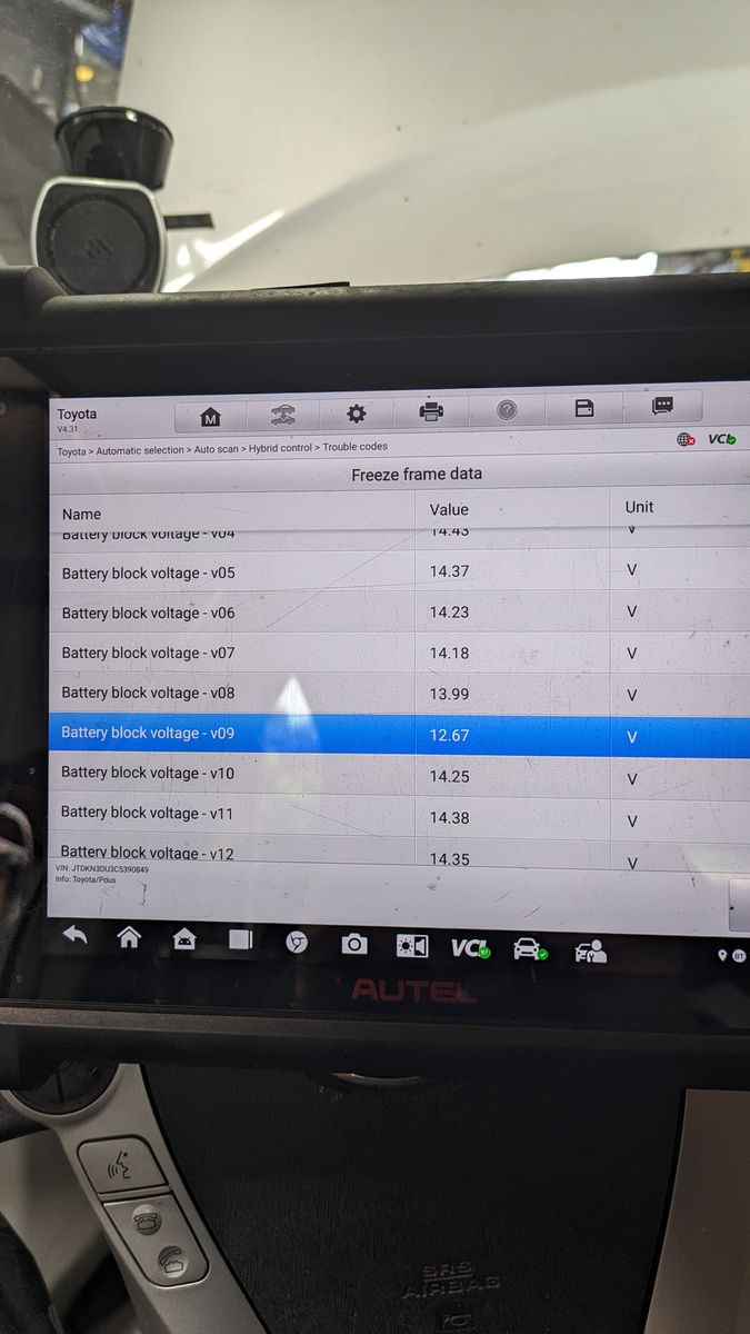

    An auto service place did look at the vehicle and used a code reader. It did bring up the code P0A80 and it shows low-voltage on one of the module. And actually @bisco, I'm hoping you're correct and that low speed on the highway and trying to not to use battery will get me 200 miles.
    And also for the hybrid battery I'm using exclusively hybrid. New battery includes the casing for around 2000. Four year warranty
