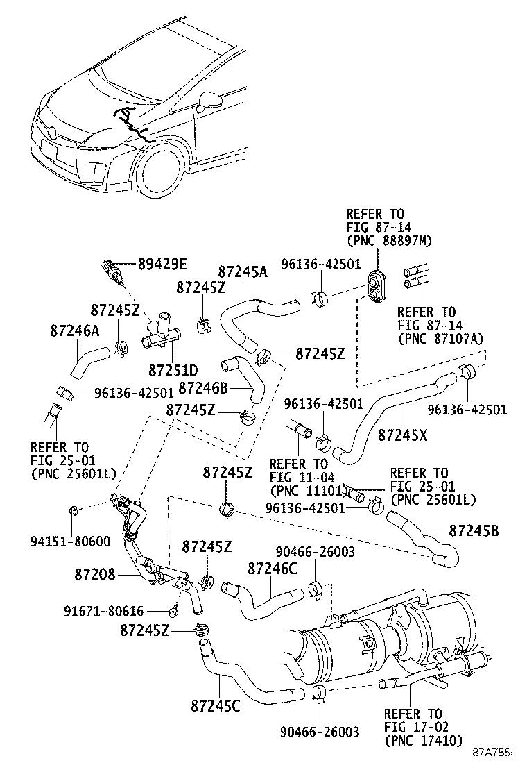

    Just to stir the pot a little, it's not really strictly necessary to connect those two lines together down there. You could also consider just plugging them. The reason has to do with the way all the coolant lines are routed.
    It's not super easy to see in this diagram, but the double-pipe thing 87208 is what carries the coolant (on its way back from the cabin heater core in hose 87245A) down to the EHRS (through hose 87245C), and the heated-up coolant coming back from EHRS (hose 87246C) comes back up the other pipe of the double-pipe thing. From there it passes through hoses 87246B and A, and joins the coolant flow at the forward end (exit) of the EGR cooler (25601L), returning to the water inlet nipple (the one that bypasses the thermostat).
    But if you look again at that double-pipe thing, you see another nipple that tees off from it with the coolant on the way down. That coolant, instead of going through EHRS, just takes the hose 87245B and goes straight to the EGR cooler (25601L again!) by the nipple at its aft (inlet) end. This is the coolant flow that actually cools the EGR (which is why it isn't sent down to the EHRS to get hotter first). After passing through the cooler it rejoins the other path on its way to the water inlet thermostat bypass.
    So if you just plugged the two EHRS ends of that double pipe down under the car, you would not be blocking any coolant flow totally off. It would just all be forced to take the other path through 87245B and the EGR cooler.
    Finally, if you compare the two options (join those two ends to each other with a hose, as most people are doing, or just stopper them off so all the flow is through the EGR cooler), you'll realize neither option is really quite right.
    As designed, the system has two parallel coolant paths there, one through the EHRS and one through the EGR cooler, which means the flow is proportioned between them according to the flow resistance of each path.
    If you join the two ends with just a short hose (very low flow resistance), overall flow in the total circuit will be increased, but it'll mostly be going through your bypass hose, and you'll have stolen a bit of flow from the EGR cooler.
    If you just plug those two ends, so the only path left is through the EGR cooler, it will be getting plenty of (all the) flow, but the total flow through the circuit will be reduced some.
    Because the cabin heater core is the first part of that circuit, you might notice slightly better flow through the heater in the join-em-with-a-hose case, or slightly lackluster heating in the just-plug-em case.
    The fix that would make an engineer smile would be to connect those two ends with a hose and a bit of restriction, chosen to have the same flow resistance as the original EHRS exchanger. Then you will end up with the same overall flow through the cabin heater, and the same portion going through the EGR cooler.
    But it might not be necessary to worry about it that much. I don't think any of the other folks in your situation have.
