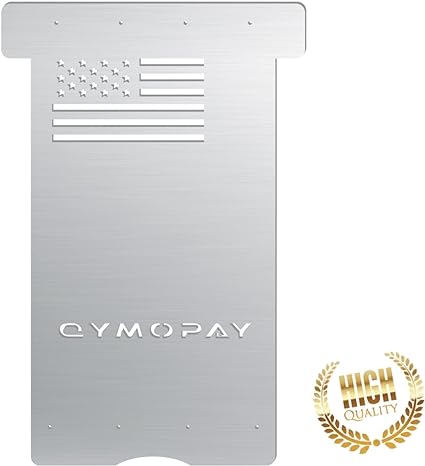

    Fwiw, below looks like the same thing, but cheaper:
    Code:
    https://www.amazon.com/dp/B09MVRBZ17
    QYMOPAY Catalytic Converter Protection shield, Fits - Toyota Prius 2016 2017 2018 2019 2020 2021 2022 for Catalytic Converter Anti Theft
    Brand: QYMOPAY
    Price: $42.99
  10. mistermojorizin

    What does installation entail? I have a friend who has a lift in his garage. Wondering if we'd be able to install it ourselves.

    If your using your friend's lift; it's literally a 5-10 minute job. Start with the first hole on the T portion and everything should line-up.
    You'll need: a sharpie marker, drill bits, good variable speed drill, rivet gun, and screw drivers.
    I bolted mine on w/tamperproof torx bolts; needed it to be removable for CARB inspections. If your going this route; you'll need (8) M4.5x12mm, of those tamper-proof bolts and a M4.5 Greenlee drill-tap bit. Otherwise, just follow the instructions that came with the shield.
    TIP - When using the Greenlee; tap ONLY 2-3 rotations in; the drill tip will be at the other side of the brace - without proper pressure; it will strip out those threads at the bottom of the brace. If your not familiar with using this type of tool; you should 'hand' tap the holes. Slower and more tedious, but you won't strip out the threads.
    Hope this helps...

    Mine came with (4) bolts; which were removable. The other holes are supposed to be riveted in. You'll need to install the bolts on the edges to center and align the rest of the holes for drilling. IMHO; once you drill all the holes; I would remove the bolts and rivet the edges down. If the thieves can pry up an edge; they can sneak a saw blade in to cut thru that cross brace. But the shield should be enough of a deterrent, when accompanied by an alarm with flashing lights.
