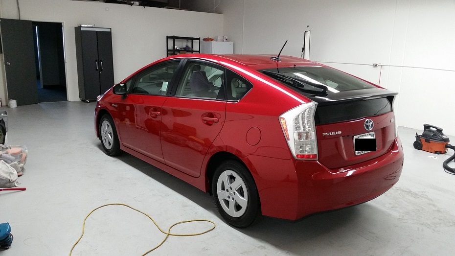

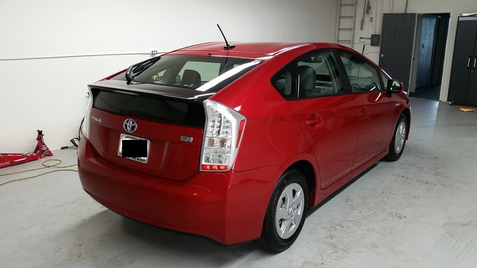

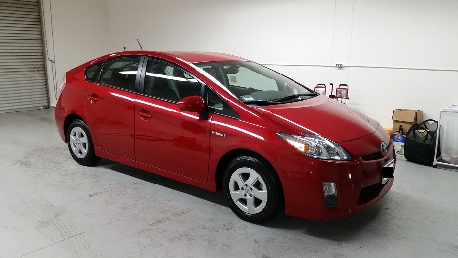

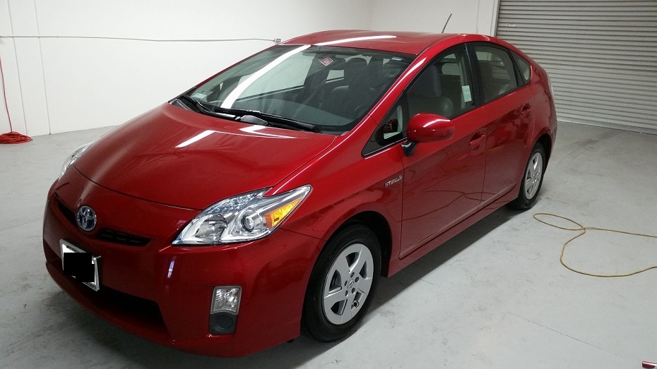

    Hey Guys,
    So after perusing the forum for a while, I was trying to find the best way to car for my recently purchased Prius's paint. I knew I wouldn't have the time or space(I live in an apartment complex) to wax a car every xx months but being a DIY kind of girl, also didn't want to take it to be washed at an automated car wash or every the hand wash place down the street...So I decided, after some research, that a coating was a good option since it wouldn't require me to wax or seal the car routinely and I'd just have to worry about keeping it clean.
    I took my car to Envious Detailing after finding out about the shop on detailedimage.com. The owner of the shop writes for the website and so I trusted him to take care of my car. It was a good decision. My prius was pampered (washed, clay'd, polished, had her deep scratches/chips touched up, and then coated with ceramic pro.) The owner did an excellent job, went over my hood twice instead of once even though I paid for a one-step process (it had a lot more swirls than any other part of the car for some reason.), taught me a lot about car maintenance, and was very transparent and honest with me. He gave me a lot of personal attention and really cares about what he does. I'd trust my car with him again and recommend him. If you're in the SoCal area, here's his site -->enviousautodetailing.com
    The color of the paint was just so much richer and deeper after everything. It'd hard to describe, but the red just looks MORE red. I'm pretty happy with my decision to go with a coating vs wax/sealant given my lifestyle. It costs more upfront, but I figured since it'll last a few year and keep the paint looking good, it's worth it to me.
    Anyway, I'll let you guys know how the coating holds up. I'm waiting for some cleaning products to come in before I wash the car. He provided me with product recommendations and I'm excited. I'm going to maintain the car with Optimum No-Rinse since I do not have access to a hose.
