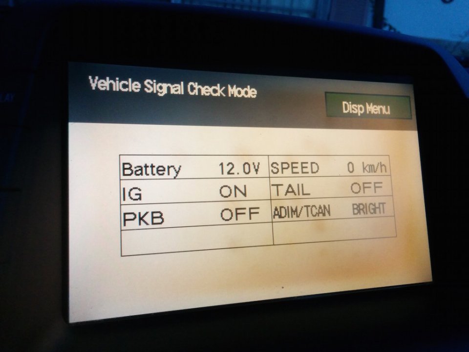

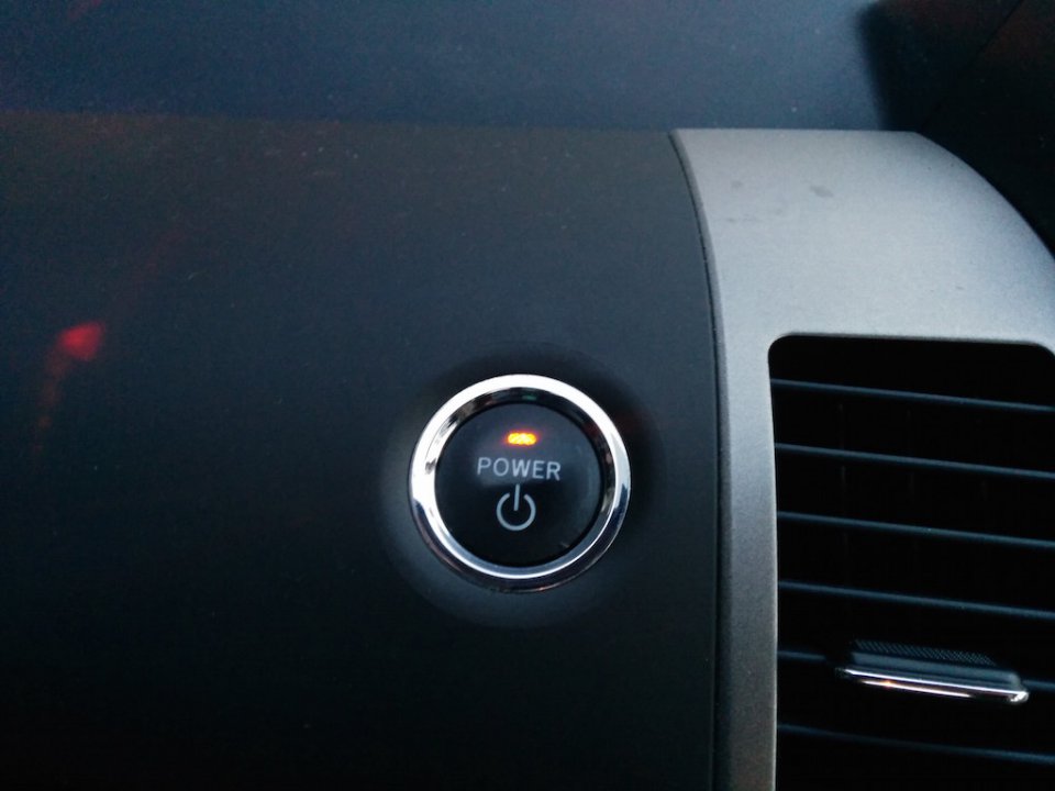

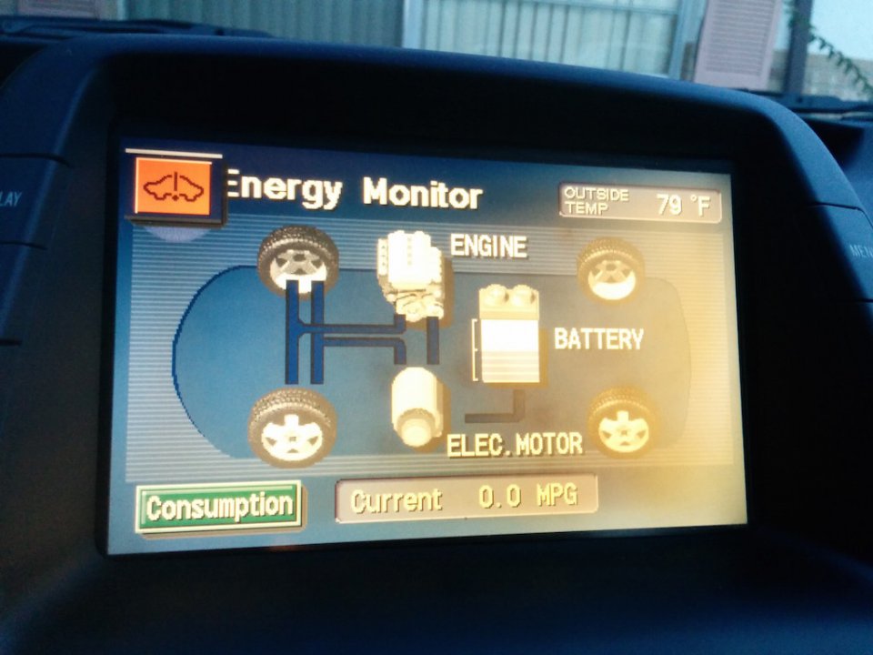

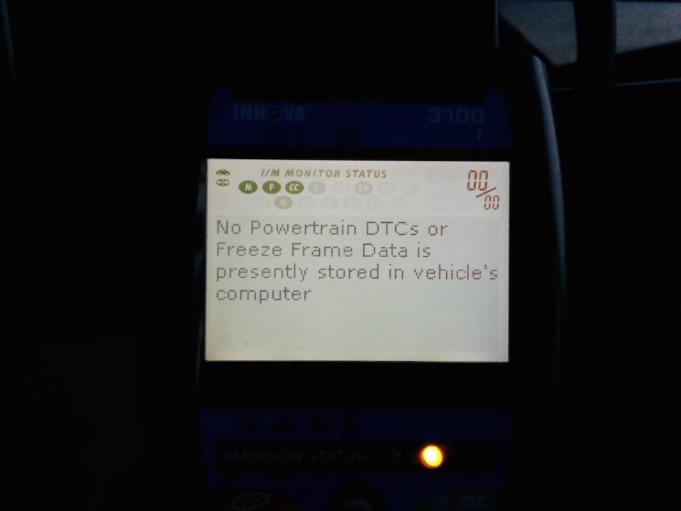

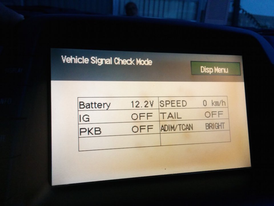

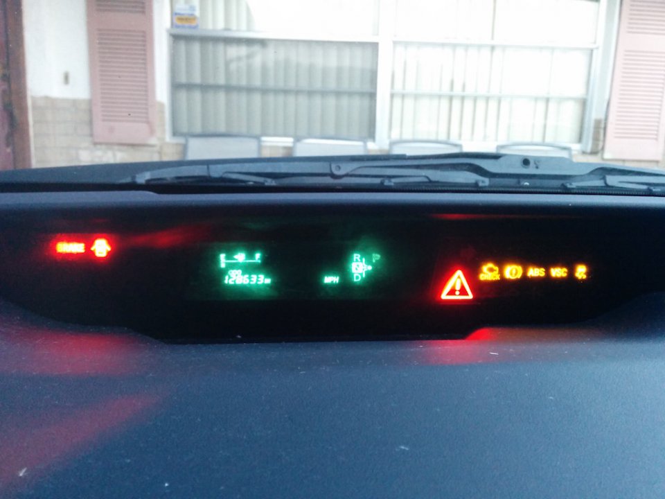

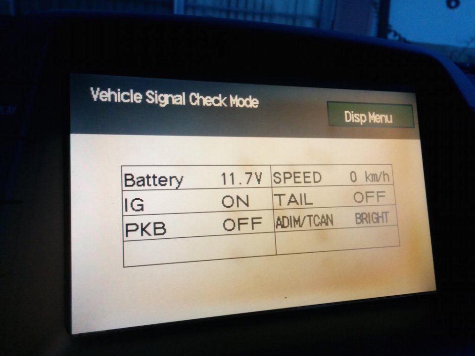

    I changed a bad cell in my hybrid battery (only one cell was bad) and put everything back together and it wont start. I've double checked all connections, fuses, everything I took off. I put the orange plug back in, fiddled with it, pushed it in more. It's got a brand new 12V battery and I dropped it off at autozone to get it charged up as well. Here are some pics and what it's showing.
    No codes and I took some pics of the battery voltage without power on and with power on.
    IMG_20141022_185054.jpg IMG_20141022_185058.jpg IMG_20141022_185113.jpg IMG_20141022_185122.jpg IMG_20141022_185413.jpg IMG_20141022_185415.jpg IMG_20141022_185440.jpg

    Do you hear relay click

    Check voltage at hybrid battery termainls at relay

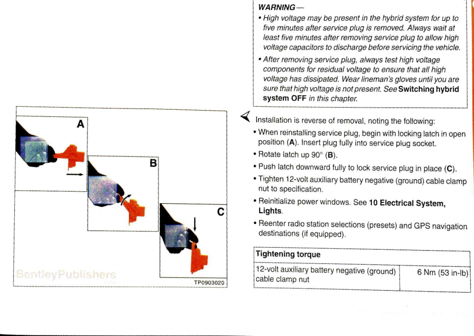

    Simple fixes first ... the all powerful orange plug:

    I'm so stupid, I didn't do the last step on the orange plug which was pushing it down AFTER pushing it in. I thought pushing it in was it! All is well, thank you so much for everyone's help!

    Don't feel bad, it is a goofy plug and it has tripped up loads of people.
