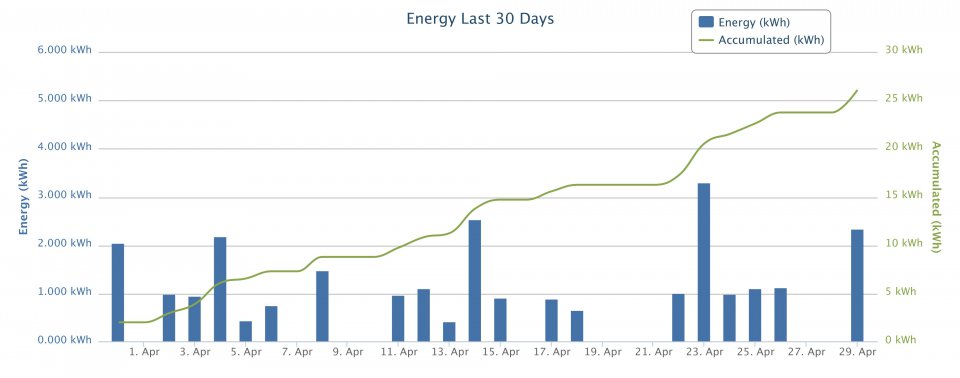

    I'd be happy to share my ChargePoint report - can't figure out how to send as an image but will try to cut and paste :
    View Energy GHG Savings Fuel Time Usage History Table By Time Period Today Last 7 Days This Month Last 30 Days Last 90 Days Last 365 Days This Year Lifetime Custom Update -- Export -- Summary (csv)
    Showing 1 to 1 of 1 entries
    CP Card#1 267004643 Session 2014-04-29 16:22:34 (EDT) 2014-04-29 17:26:19 (EDT)
    2.326
    0.00
    0.977 01:03:45 196 E Main St, Milford, Massachusetts, 01757, United States

    If you have a windows PC, use "Snipping Tool" to capture a screenshot of Your chargepoint report. save it as a jpeg
    fortytwok likes this.
  10. fortytwok
    fortytwok Active Member
    Mar 25, 2013
    467
    139
    Hopkinton MA
    2013 Prius Plug-in
    hope this works :
    edit - thanks Kitty!

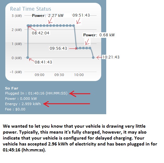

  18. ny_rob
    ny_rob Senior Member
    Feb 28, 2012
    1,968
    813
    L.I.- NY
    Here's a typical (old style) ChargePoint graph for my PIP starting with less than 1EV mile range remaining when I plugged in...
