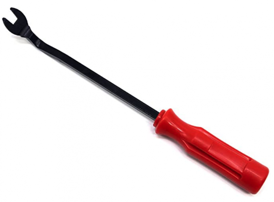

    I was watching Nutz and Bolts video on cleaning the fan that cools the main battery
    I think I have all the tools needed except the plastic pry tool
    Do I really need that ?

    No.

    What do you use?

    161
    Flat head screw driver

    I guess I'd have to go look at the video. Are you using it for removing the cable clamps? I use a clip removal tool.

    First time, I found the fasteners attaching hatch deck to top of battery very stubborn. Left most of them off.

    Correct on the seat removal. I never remove the seat to get out the fan. We clean the fans on every hybrid that we sell.
    They sure like to stay attached to the top of the battery case. LOL! That's another use for the tool I mentioned above.
