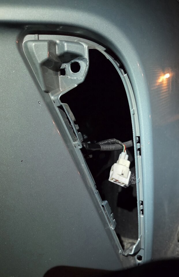

    I removed the flat black plastic panel on the front bumper and found this connector.
    I assume Red=power, white=ground, green=turn signal.
    Can I hook this up and have working lights there?

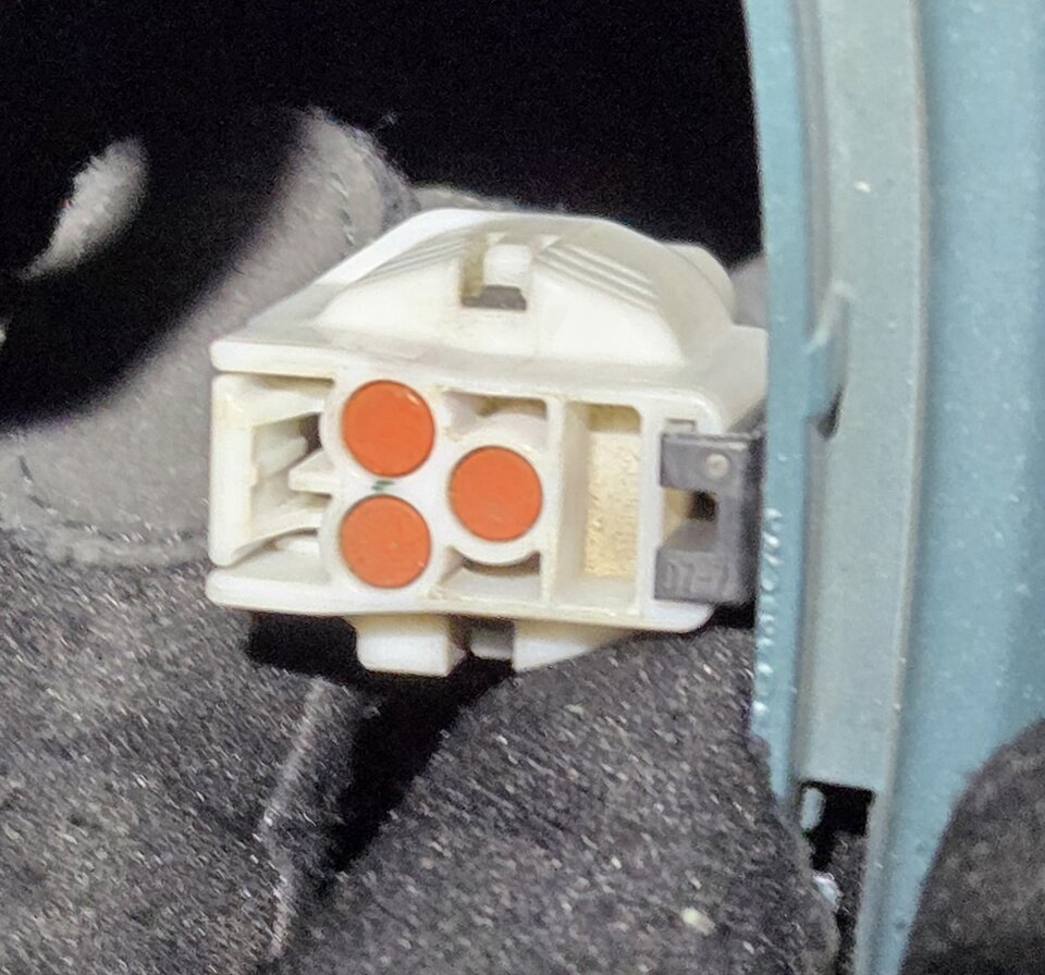

    The white connector with the 3 orange plugs comes off to reveal a fully-functional power connector.
    *This plugs into the Cord Assembly.
    *The Cord Assembly has 2 tails, one of which plugs directly into the LED Illumination Lamp Assembly (the other tail is for fog lights - seal it off to prevent fouling or short circuits).
    *In the passenger-side fuse box in the engine compartment there is a missing 10A fuse (the only open slot in the fuse box). The web site "startmycar" and the fuse box map lists it as "DRL" (see photos).
    The clearance lamps turn on and off along with the main lights just as they should, OEM-spec.
