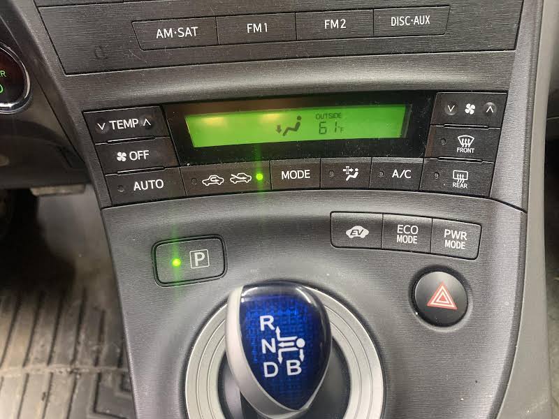

    Hello! I have a 2011 Prius. When I set the vents to blow air out of the dash several minutes later the climate control re-directs the air flow to the floor. When I “re-select” the vent direction to blow the air out of the dash mounted vents the AC button illuminates. I then de-select AC and then several min later the airflow re-directs to the floor again repeating the cycle. I would like to specify that the “AUTO” button is “NOT” illuminated when all of these shenanigans are occurring. Any advice or first hand experience on how to resolve this would be appreciated.
    * I did search the forums before posting this question but the threads that I found did not come to a resolution. The photo is only to illustrate the style of climate control panel in my Prius.
    Thank you Prius Chat!
