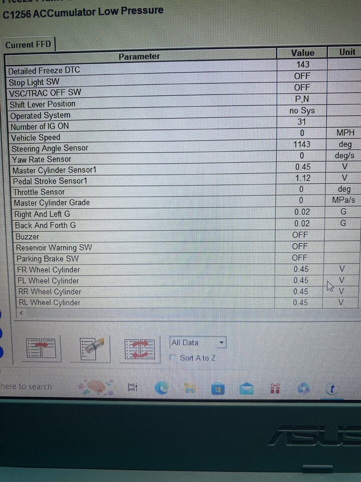

    I have an 04 Prius that had a break actuator that was cycling every few seconds so I replaced it with a used one and bled it using tech stream and everything was fine. Now every few weeks or even months I will get the brake warning lights and high-pitched squeal. I can shut the car off and the problem goes away when I restart it, I replaced the 12 V battery. I have a few other codes, but I don’t think they are really related to it I enclose some freeze frame data. If someone could help me interpret it I would appreciate it IMG_4433.jpeg
