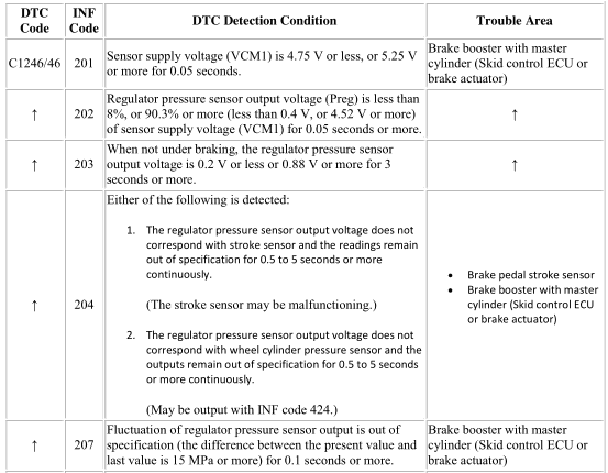

    42 on ABS just means to pay attention to the code on ECB ((!)). That's explained here: Blink (a/k/a Flash) Codes – How to. | PriusChat
    So, 46 on ECB. C1246 code. Not one we see a whole lot of here. Problem with the regulator pressure sensor in the brake actuator assembly. With a scan tool that shows INF codes, you'd get a 201, 202, 203, 204, or 207 (and maybe 424?) pinning down the problem more specifically:
    That regulator sensor is built into the brake actuator assembly. You also see it in that table being called the "booster with master cylinder" or "skid control ECU", never mind, those are all the same thing (the one on top here):
    Just don't confuse that "brake booster" with the "booster pump"—that'd be a different thing (the one on the bottom).
    Because the regulator sensor is built into that actuator assembly, there might not be a lot of clever use for you to make of the specific details from the INF code: if that sensor's bad, the whole assembly gets replaced. But I do notice that INF code 204 could come up because of a problem with the brake pedal stroke sensor, so if that's the INF code you've got I would definitely check that before springing for an actuator.
    The table above is from the first page of the troubleshooting instructions (there are five pages for that code) in the repair manual.
