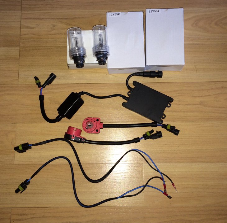

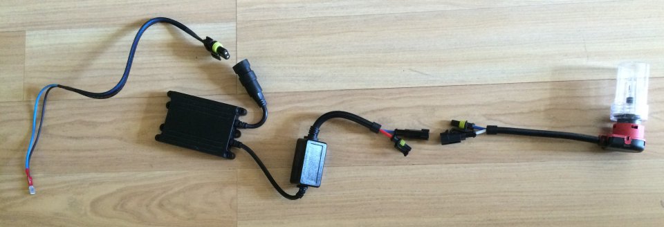

    I thought that my OEM ballasts were going bad, One side was flickering and the other would light up and turn off and i would have to turn on/off the lights to get them going again. Then the other night the driver side went out completely. In a scramble i contacted 2 famous guys on this board for some help, (thanks Justdidit & Evan) thinking that it was the expensive Denso ballast. Some did a conversion over to after market HID's so i'm local to DDMtuning here in San Diego. Picked up 55w ballast HID kit, with D2S 5K bulbs with D2S adapters and the extra wire harness to install into the DDM ballast. This kit was $55.
    You have to remember.... The only Bulb that will fit into these housings are D2S / D4S bulbs so finding a halogen bulbs would be hard or my thought was NEVER to go back to Halogen.

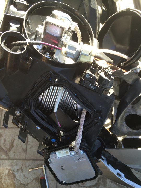

    Started with the Driverside headlight assembly all that was needed was a phillips screw driver and 10mm socket to get the lights off. Much easier that to get your hands into the backside of the light. But i needed to find the power source for the headlights. I started checking for continuity from the car to the light. No power, went to the passenger side and found power pretty easy, consfused... so i opened the fuse box behind the driver light and found the problem. I bought the car with a salvaged title, completely repaired before i got it. Found my problem. The fuses that control the headlights were 30amp fuse in the driverside and 15amp (equipped from oem) swapped the fuses and my power to the driverside headlight was available. The light works and so i didn't continue with my DDM install.
    Stock Ballast is 35w and what i got was 55w much brighter than stock so i may end up installing this at later time.
    Install IF moving forward:
    D2S/D4S light bulbs will ONLY fit into the HID housings, Plug the DDM adapter to the bulbs, Drill a hole and seal completely with rubber silicone the round locking cap the goes back into place, the DDM adapter into the DDM Ballast and the other DDM harness (SPADED end) might be have to be cut off and but connected or soldered into the factory power source.
    any questions, Let me know. Thanks! Mike
