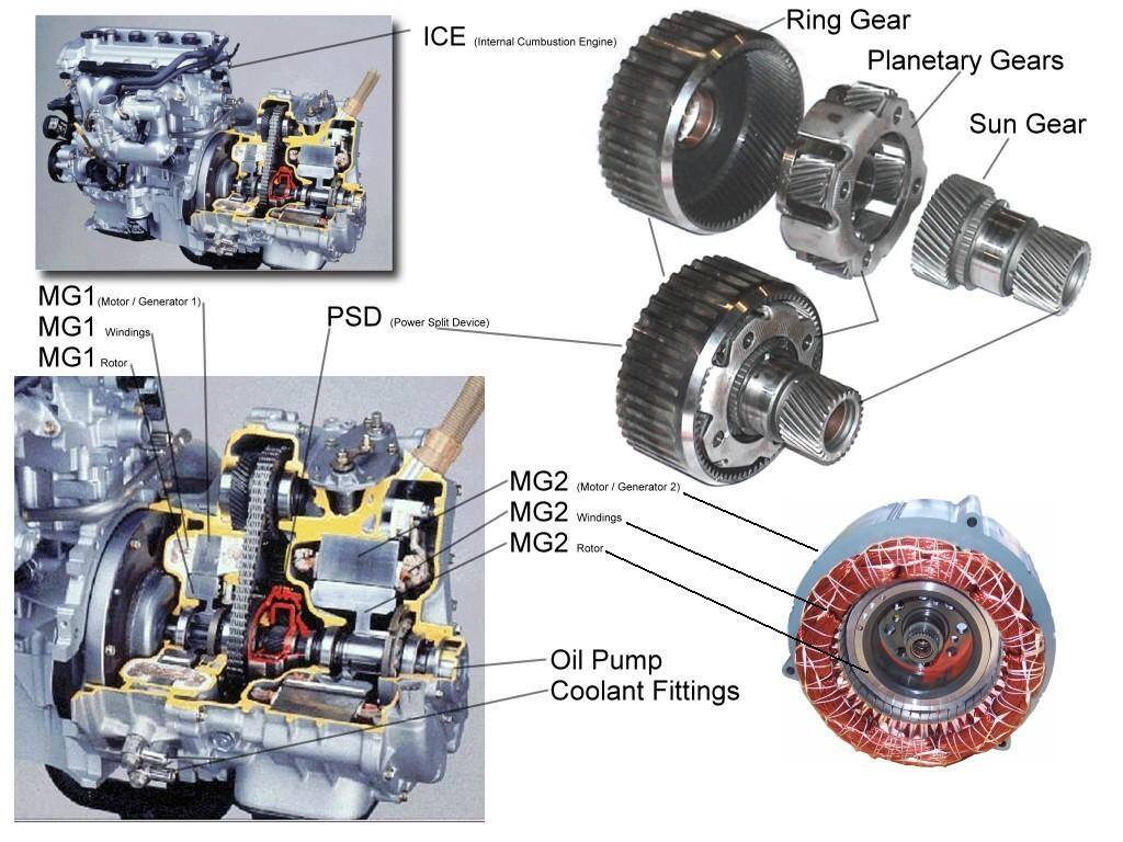

    Do these help? 8)
    I'd like to know more, as the Mechanical Engineer in me is absolutely amazed at the PSD!

    Your first picture is exactly the one I was thinking about. The chain looks real robust. I see that it is positioned between MG1 and MG2.
