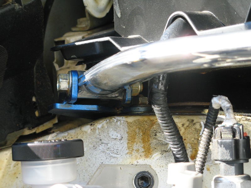

    I'm looking to install this strut bar but can't find the torque specs for the nuts on the tower...any advice is greatly appreciated.

    M10x1.25 J.I.S. flange nuts with 14mm hex. Torque to 38 ft. lbs.
    Bolts are weaker 8.8 DIN with multiple washers. I replaced them with 10.9 J.I.S. flange bolts and nuts.
