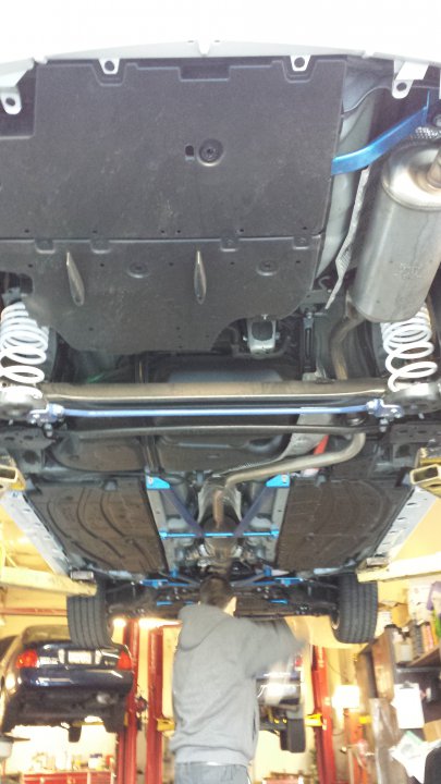

    In deciding whether or not to get the Cusco rear sway bar I crawled under my v and looked at the attachment points. These are at the bottom of the coil spring mounts where vertical wheel movement can be better controlled by a sway bar.
    Looking at the situation I can see that a sway bar will dampen the inside wheel lift in tight, higher G corners. It will keep my v from looking Volkswagen-like silly in corners (inside rear tire lift-off) when I autocross it and give me better control on those exciting off ramps.

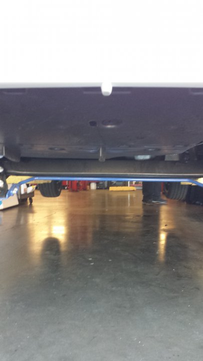

    20141029_083236.jpg Here's the cusco rear sway bar on a Prius 2013
