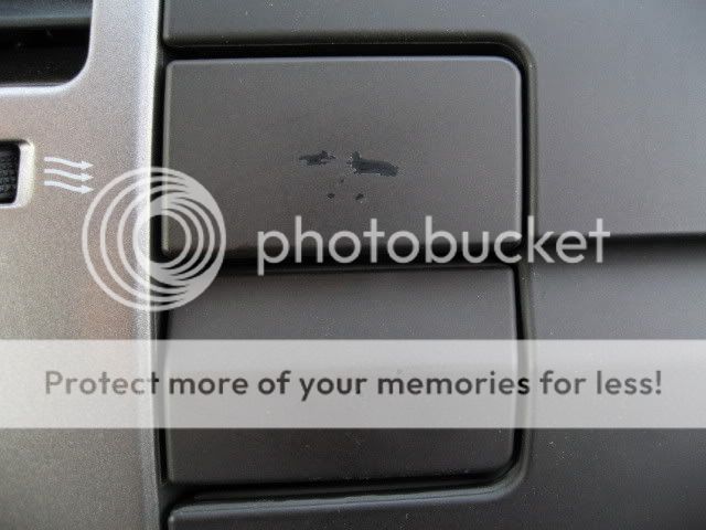

  6. bshef
    bshef Active Member
    Jun 6, 2004
    510
    76
    OC So. Calif.
    Here's a pic of the glove box button.....

    With my 2005 Prius out of warranty, having the dealer fix the scratched/peeling paint on the glovebox buttons was out of the question. With a bit of research, and various samples ordered, I found a 3M peel-and-stick vinyl film that matches the glovebox finish almost perfectly. Just cut a piece to the size of the button, and stick it on.
    3M Scotchprint 1080, Matte Black
    You can order a sample piece from Metro Restyling - Carbon Fiber Vinyl - Camo - Woodgrain Vinyl Wrap for only a few dollars (and it is sufficient to fix both glovebox buttons on more than one Prius).

    Thank you very much, Solar_Powered! I think I'll do the same on my '05 Tideland:
    (Color is off on photo, in reality the color is identical to the photo upthread.)
  14. coyote2
    coyote2 Member
    Jun 29, 2004
    128
    30
    Wow, applying "3M Scotchprint 1080, Matte Black" was really easy, and a perfect color match.
    I do wish I'd removed all the paint first however; from some angles one can see where the paint had peeled off (it's just that the "3M Scotchprint 1080, Matte Black" is lower there).'
    Seems like it would not have been difficult to remove all the paint first; it came off with my fingernail. I wonder what would do the job easiest/smoothest/cleanest. (Edit: I'll never know, since removing the film to replace it peeled off all the paint it was over very cleanly; so I guess any kind of adhesive tape would have done as well.)
