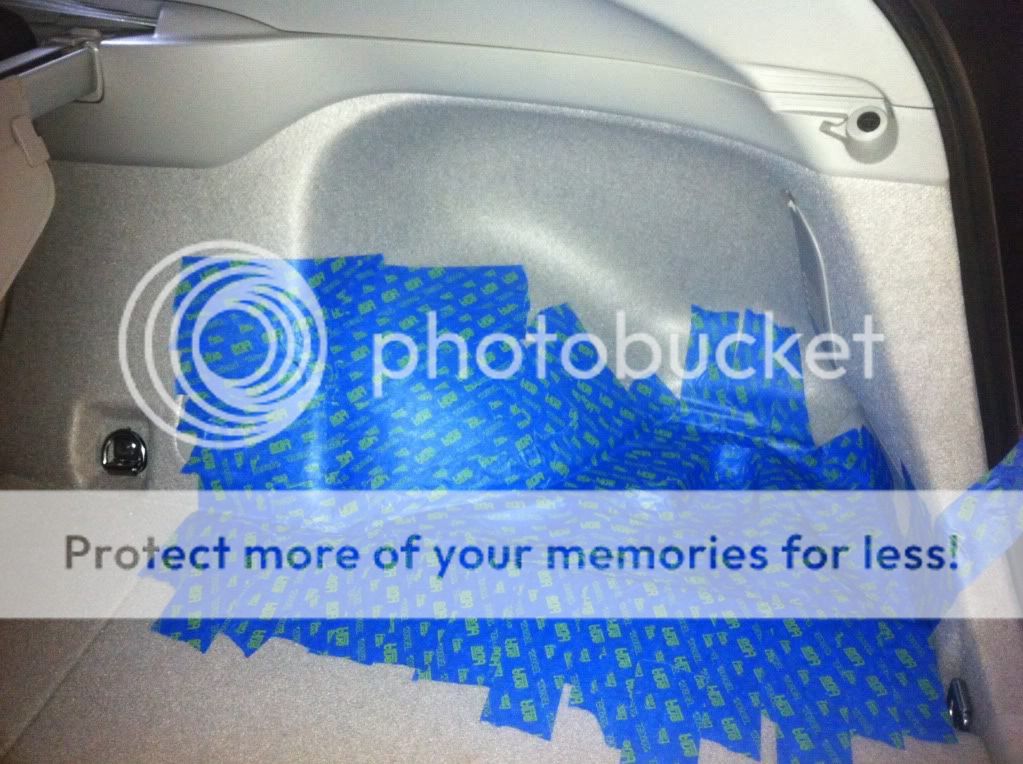

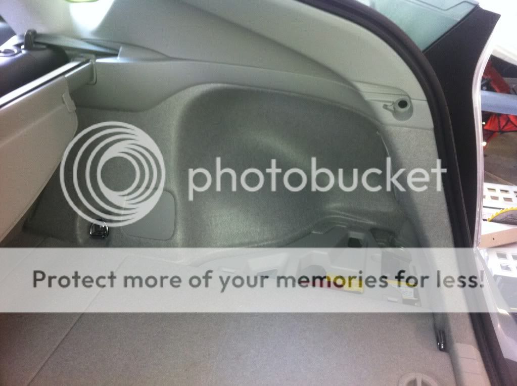

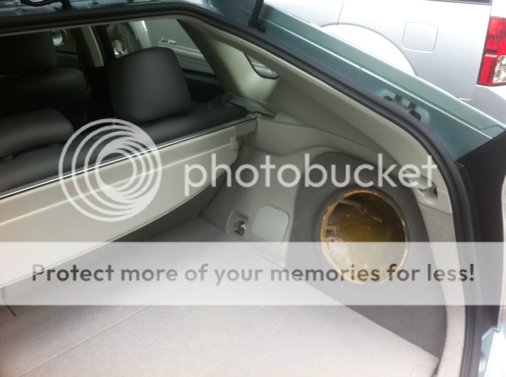

    I still can't believe that there is no company that makes stealth sub enclosures for the Prius. The right rear cubby is the PERFECT spot - such a deep little recess of wasted space. Below are some pics of the process of building the stealth enclosure. I dropped my car off at the stereo place earlier this morning to get everything installed. I can't wait to hear how it sounds.
    Anyways, here are the pics of the enclosure being built:
    The perfect location:

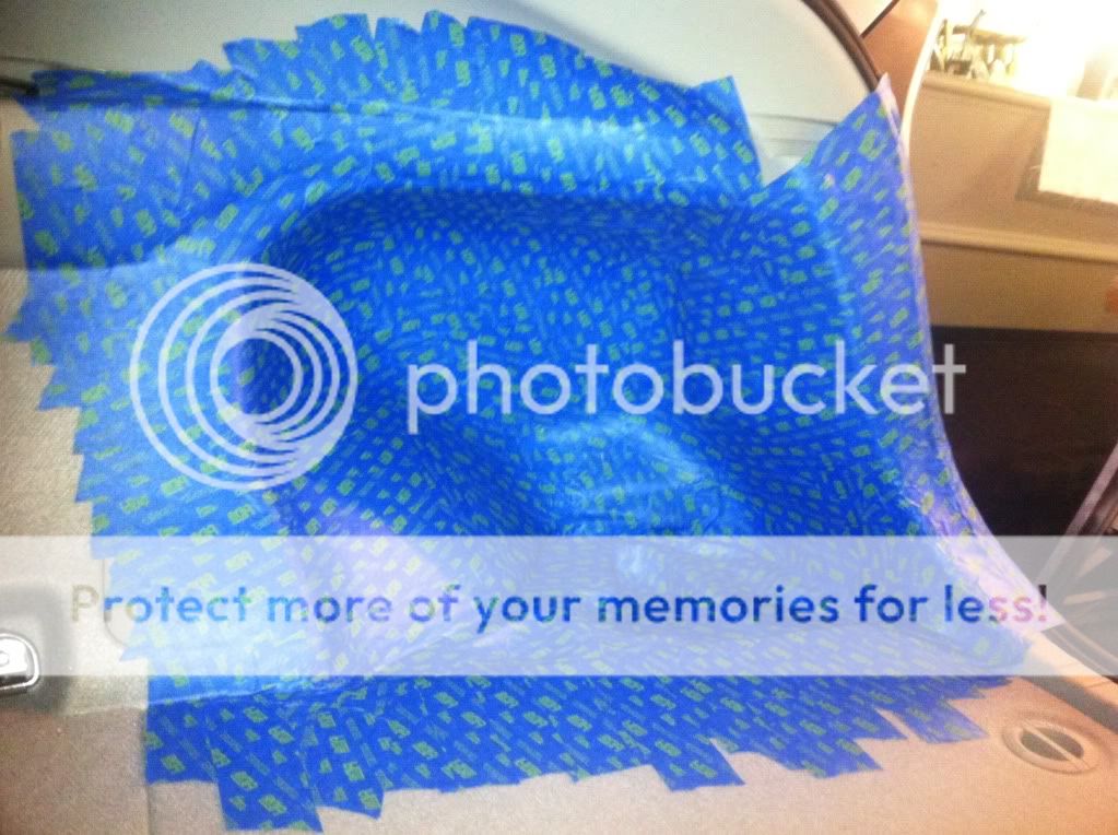

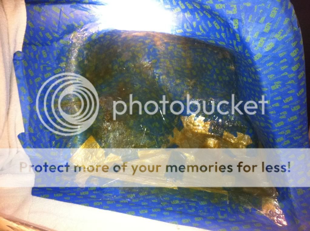

    masking took a little longer than I thought...here it is about halfway done:
    Getting there:

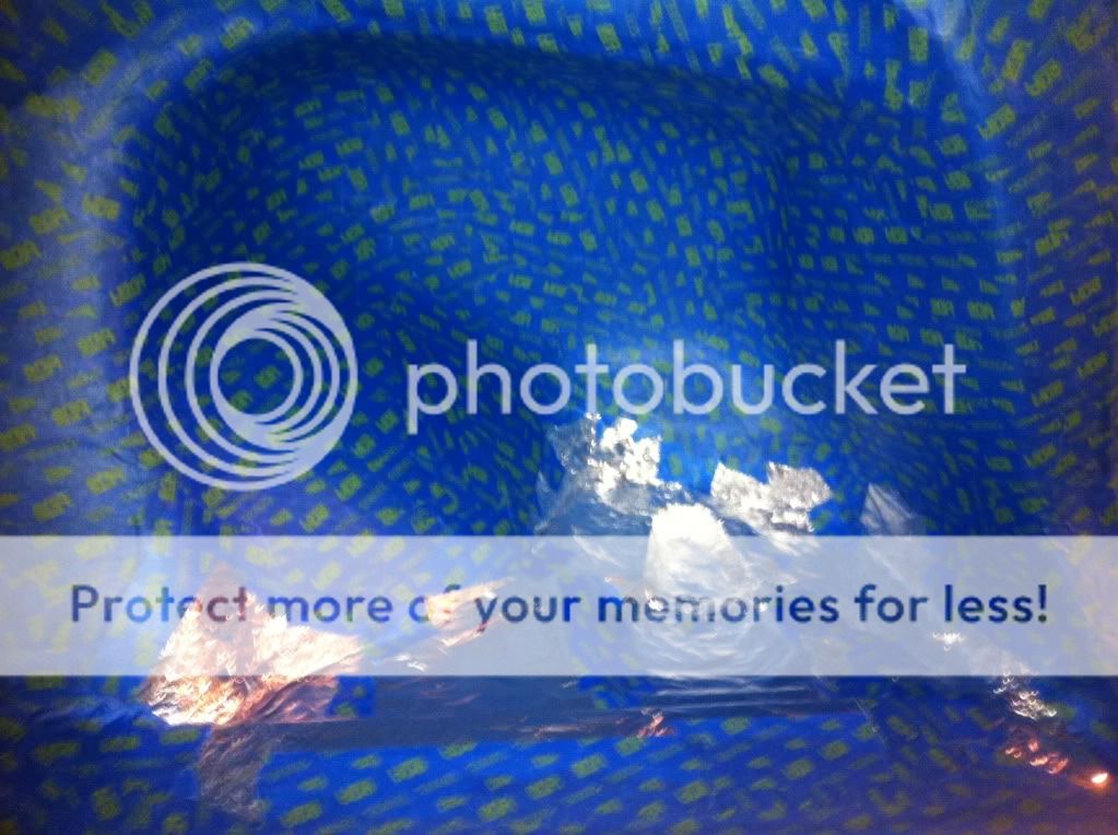

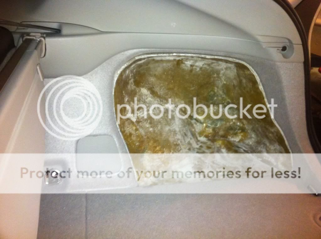

    I put some tinfoil down on the bottom to prevent any leaks and also to make the mold easier to pull out once the first layer of fiberglass is dry:
    Ready to start the glass work:
    First layer of glass and mat:

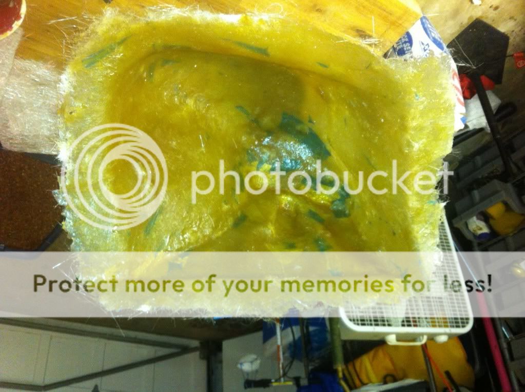

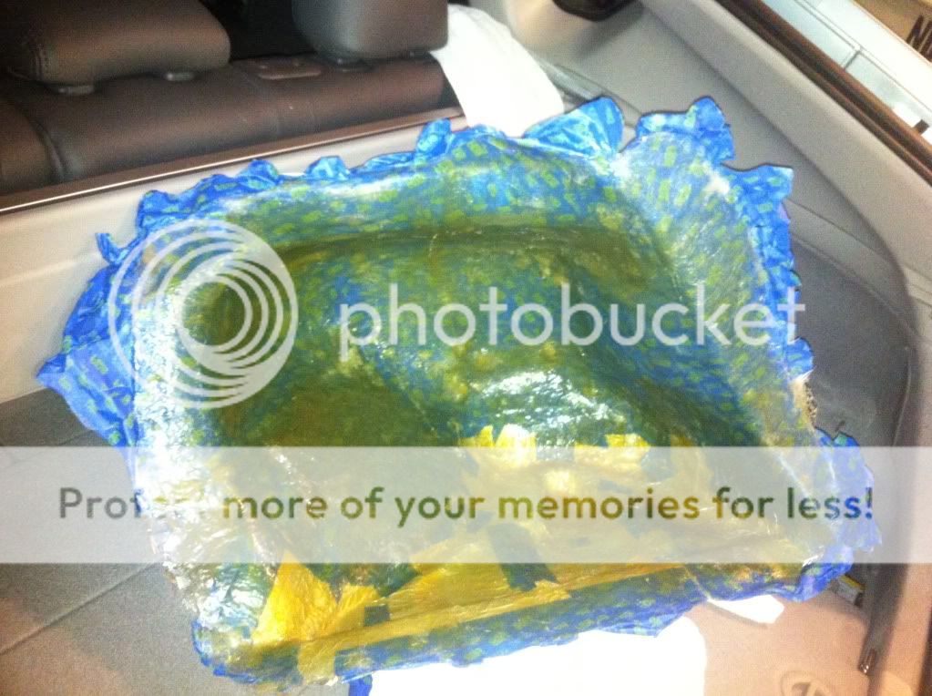

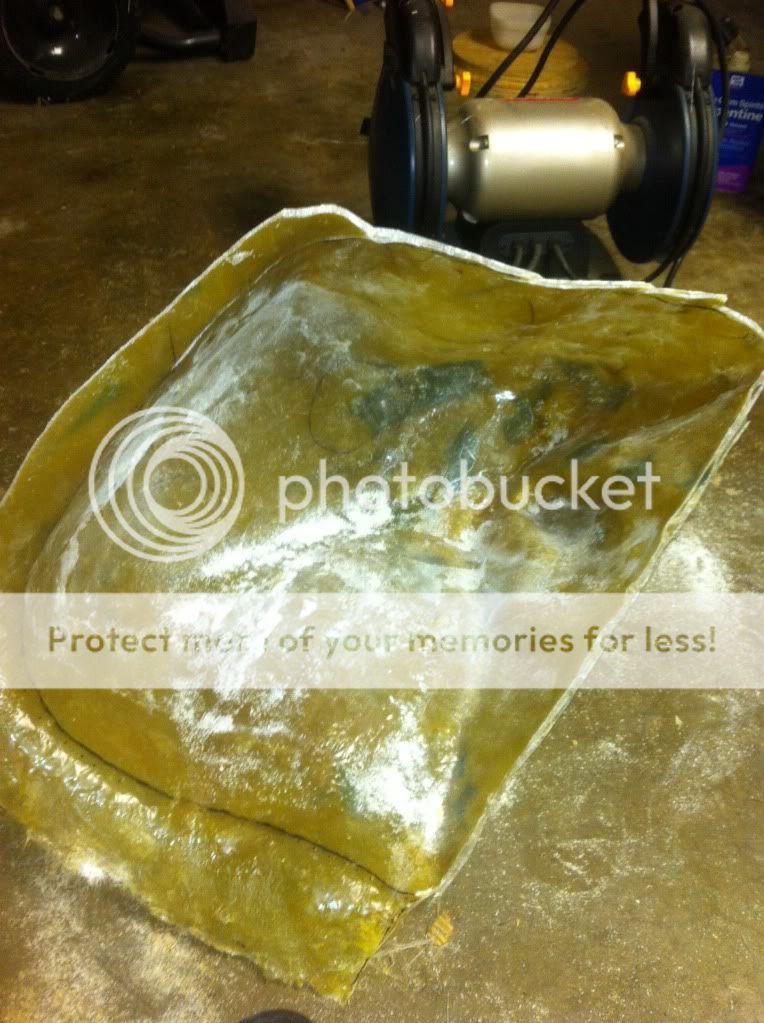

    It took some tugging, but finally got the mold removed from the car:
    Another pic of the mold after removing from the car:
    Starting to cut off the edges:

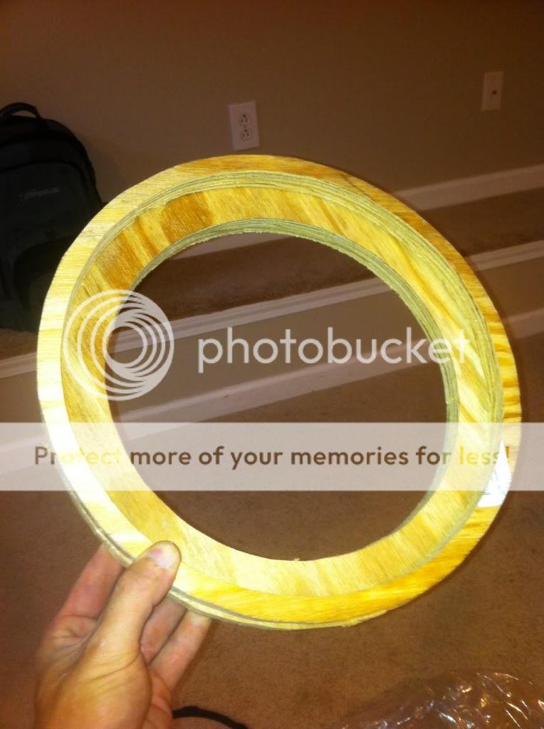

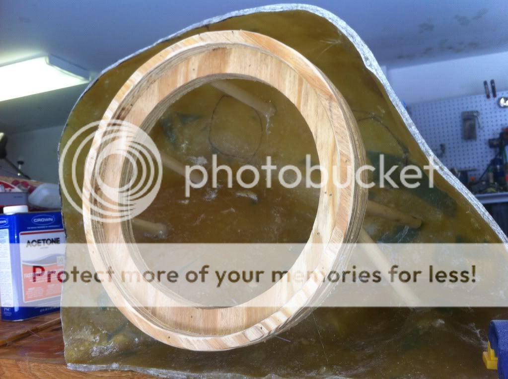

    Now to make the rings:
    Recessed ring:

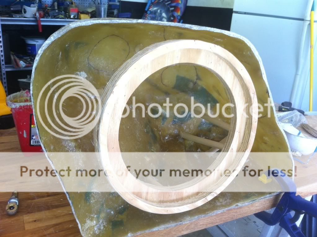

    I used some small clamps to hold the ring in place so that I could brace it:
    Braced with 1/4" dowel rods:

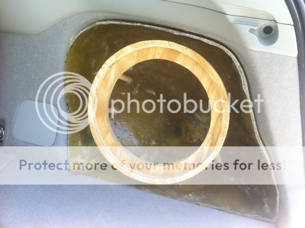

    Another test fit:

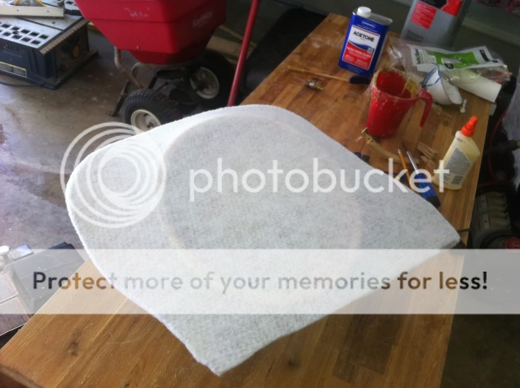

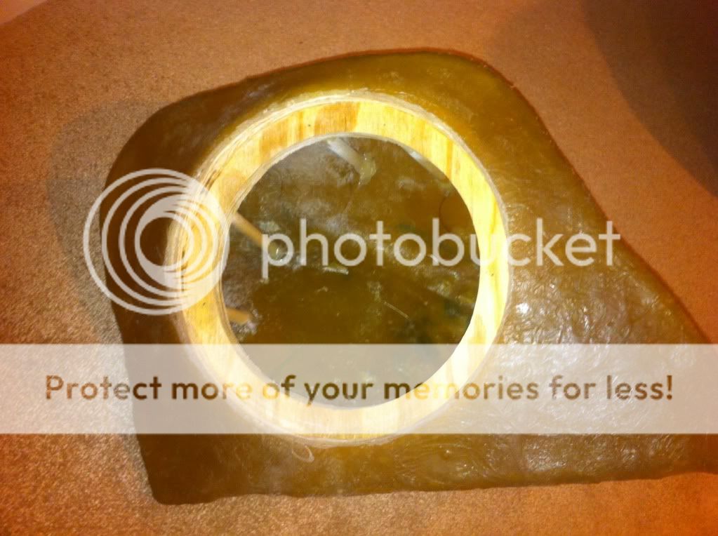

    Polyester fleece stretched and secured with dabs of hot glue on the back of the enclosure:
    Lots of glass resin being soaked up by the fleece:
    2 more layers of mat and resin and trimmed flange:

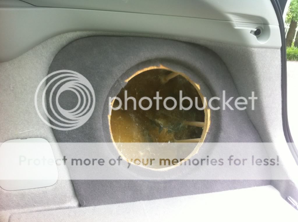

    Carpeted and ready for the install:
    I should get the car back from the shop later this afternoon. I'll let you all know how it sounds. :)

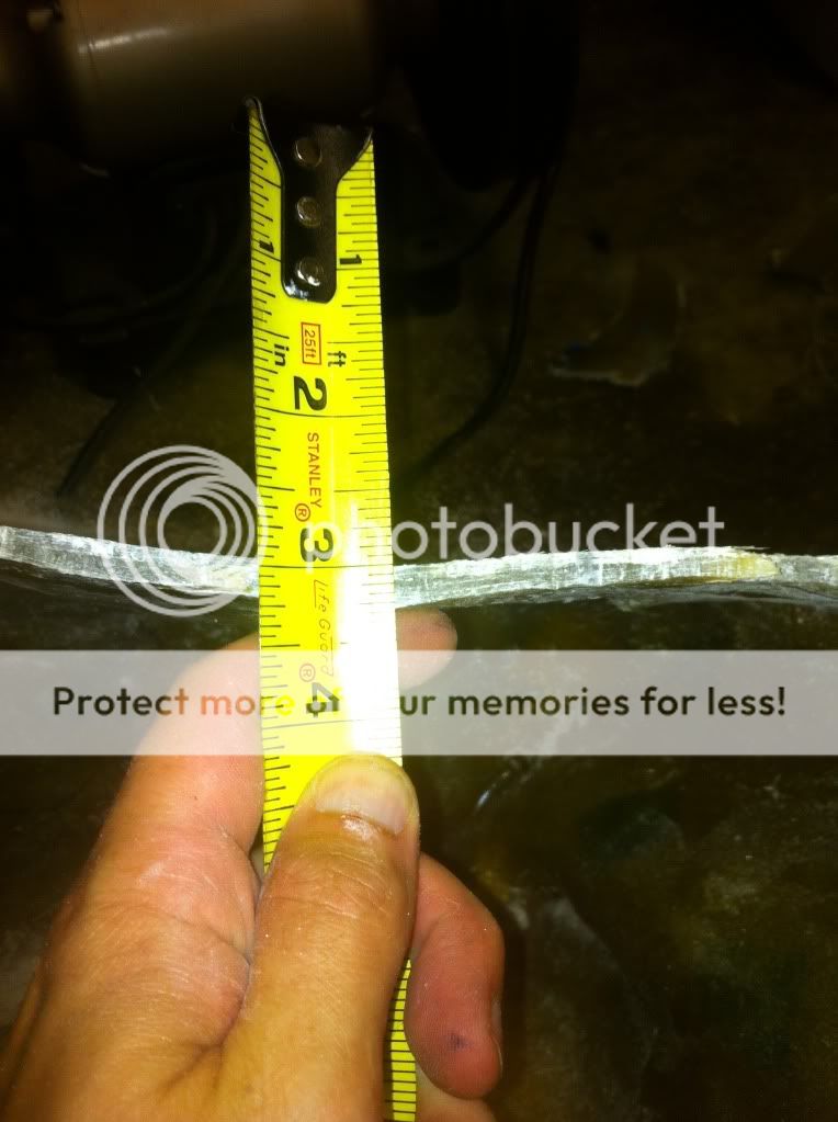

    It looks great...... you need it to be at least 3/8- 1/2 thick for it to work properly, Think about using Hushmat behind it and on the floor of the trunk to soak up some of the Resonance.
    Did you fill it with water and measure it to find out your airspace?
    Keep us updated on how this turns out?

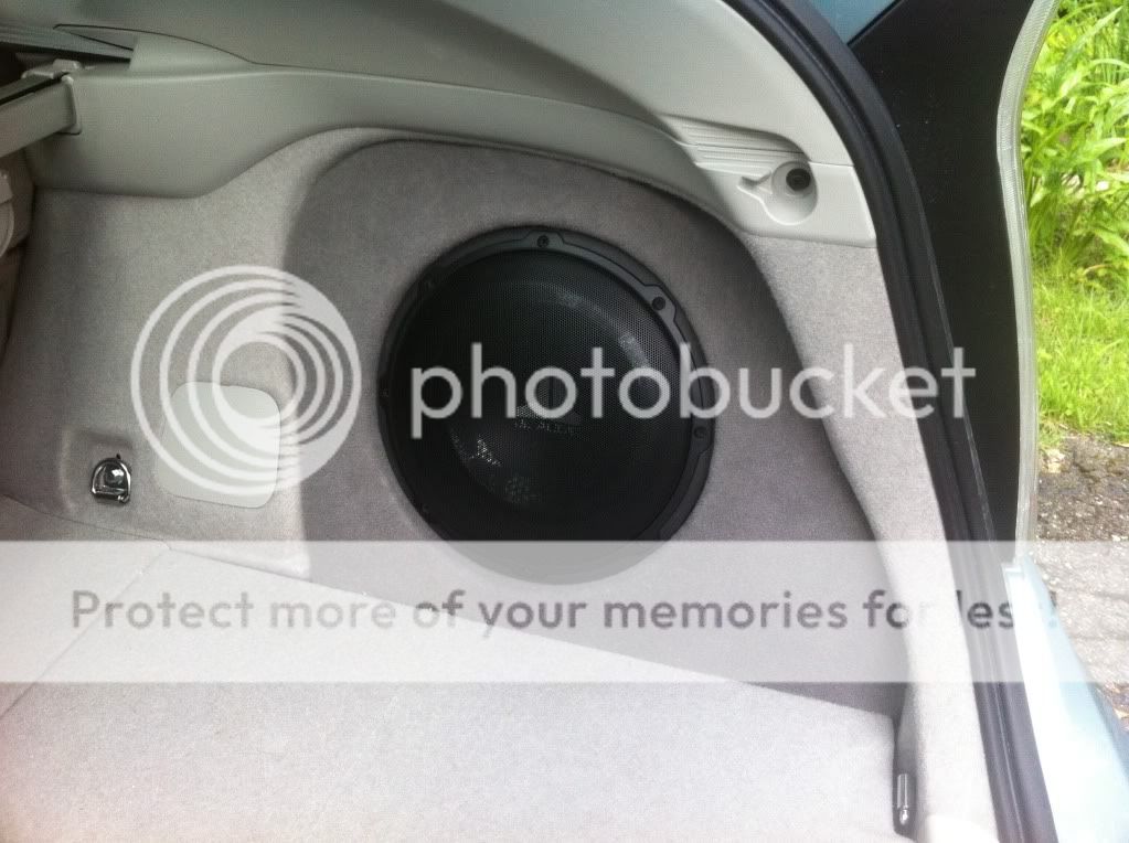

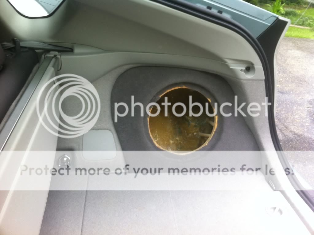

    I just got the car back and I must say that I am very happy with the results. VERY clean and crisp sound. The installer left the factory dash speakers hooked up and said to come back after some listening if i still wanted to have them disconnected. So far, i don't see any need to disconnect them. They sound pretty nice and i don't notice any distortion coming from the dash - even when the volume is cranked. When I first started the car and listened, I was a little put off by the amount of white noise coming from the speakers at a volume of zero. The installer had set the input sensitivity on the amp to about the 1 o'clock position. Once I dialed it back to an appropriate level, it was much better.
    My sub enclosure is nowhere NEAR a half inch thick, but it is performing AWESOME. Even the installer commented on how good the box sounded. On the edges where I could measure, it was about a quarter of an inch. I am sure it's thicker in some places and thinner in others, but regardless, it's very substantial and seems to be doing the job.
    I also had a volume knob installed so that I can control the level of the sub. Most aftermarket radios have this built in, but this knob is really cool for my factory HU.
    And finally, the sub installed in the box

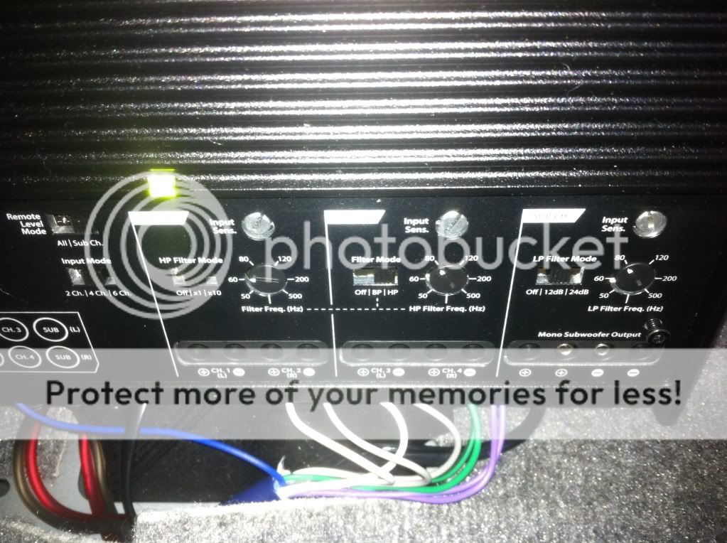

    Well, I finally got around to reading the manual for my amp and made some tweaks. It's sounding NICE now. How is it that stereo installers are so good at "installing" but so terrible at "configuring"? It blows my mind. I mean the dude at the stereo shop sold me on putting 6x9s in the front doors and installing hushmat because of how much better the bass response would be in the front soundstage...but then he sets the high pass for the 6x9s to 80 Hz...these 6x9s are rated down to 40 Hz...what a wasteful setting he chose. Anyways, I've now got them x'ed at 60 Hz. Rear doors at 80Hz and the LP for the sub around 80 as well. Gain is at tge lowest setting for all door speakers and at around 11 oclock for the sub. Sounds very smooth. Here's a pic of my settings in case anyone has any suggestions. I'll try anything.

    I take back what I said. I just did this, mine has about 5 layers of glass about 1/4" thick and you could support the car on it. Thanks for the inspiration.

    It's pretty common to set the crossover points around 80Hz for your front stage, especially when you have the sub picking up everything from there down. Just because your 6x9 have response down to 40Hz doesn't mean you want them trying to do it....the sub can do a much better job with those frequencies. You may notice when playing certain music that the 6x9's distort when they try to go that low.

    Common or not, I think the system sounds way better with the fronts crossed over at 60 instead of 80. I have not heard any distortion whatsoever - even when listening at high volume.

    Looks awesome. One question, I have seen subs with huge enclosures. There is a min. requirement for air. Does this enclosure have sufficient space for travel or is it a sacrifice for the sake of appearance?
    Thanks

    The ones I make for the same space slide in place (retains the cover over the battery) is just around .5 cubic feet. Most of my customers are using the 10" JL speaker and are very happy with the results.

    Most subs have a minimum requirement of .75 sealed at least, but that's recommended as the sub will perform its best with the correct amount of space. You can run it in a smaller box for appearance sake but the woofer will not be as efficient or loud.

    The JL's that my customers most often use require .674 cu ft. With polyfill, they can get just about spot on to this volume. When all is said and done, they are very pleased with the results, as is YoungClayB, I'm sure.
