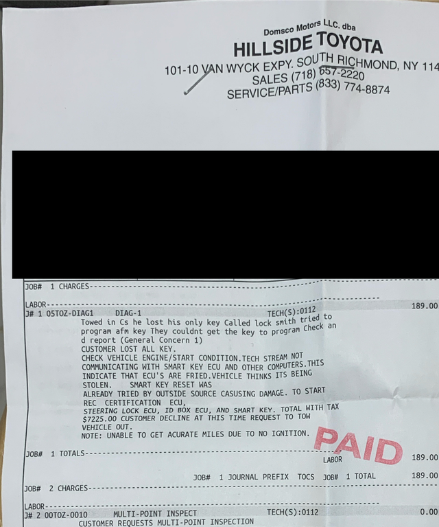

    Recently I spent tons of money on My 220K miles Priuc C 2012. Renewing Hybrid Battery, and the whole AC system, but never thought that I will get into this situation in just matter of weeks when I lost the only key I had for the car, I tried to find it but with no luck, then, I brought a locksmith service.
    The locksmith technicians said that they're licensed and certified from Toyota to do their locksmith and programming the new key, they even asked to pay extra 75$ for a license special to the smart key, but it turns out, they didn't even follow the right steps of reset.
    After they left, the start button din't show anything on the dashboard. Just the immobilizer lock blinking all the time.
    I towed it to Toyota, the image is the diagnosis result.
    I am completely lost and devastated. I'm unemployed and was just about to start looking for a new job, that having a car is essential for most opportunities. So my question is:
    Is there a way to start the car? I've heard that hardwiring might work, but the diagnostic report indicates that the steering is locked. Is it possible to jump-start the car by directly connecting the electric motor to the power source and bypassing other modules like the following?

    There is probably a lot less "fried" than this dealer thinks, and that looks like the sort of estimate a dealer gives when they really mean "we have other customers with easier jobs than figuring yours out".
    A good hybrid shop that's willing to just do a bit of diagnosis can probably find and fix the issue for a lot less than that. Trouble is, I don't know what the good hybrid shops are in your area.

    I hope that there a good shops that can find a solution, I hope also the parts they mention are available as used,
