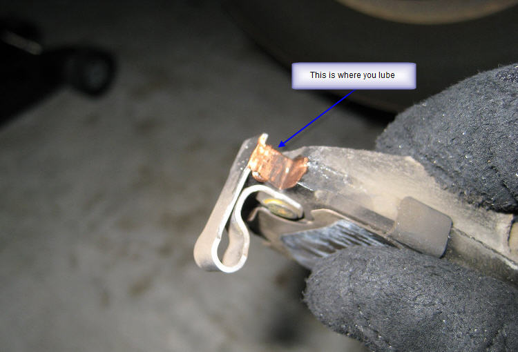

    Thank you. You are talking about the clip on the actual brake pad? Like this? (not mine). Yes, my replacement pads have it.

    The couple of things I'm thinking of: the anti-rattle springs, and their holes in pad edges, and the pins in the center/back of the pads. I've highlighted the springs in yellow, and the pins are flagged with red arrow:
    Another pic, the pins flagged with arrows (only the piston side pad actually needs the pin) and the anti-squeal pin hole loc's circled. These are pads/shims I purchased through dealership, for a bit over $100:

    I can't see those V-shaped springs doing a lot. (Do hang on to them though.) You can assemble the pads/shims, place them in position on the rotor, then squeeze the springs in and pop into the holes on the pad, take your hand away, and the pads will hold in position till you're able to bring the caliper back and slip it over them.
